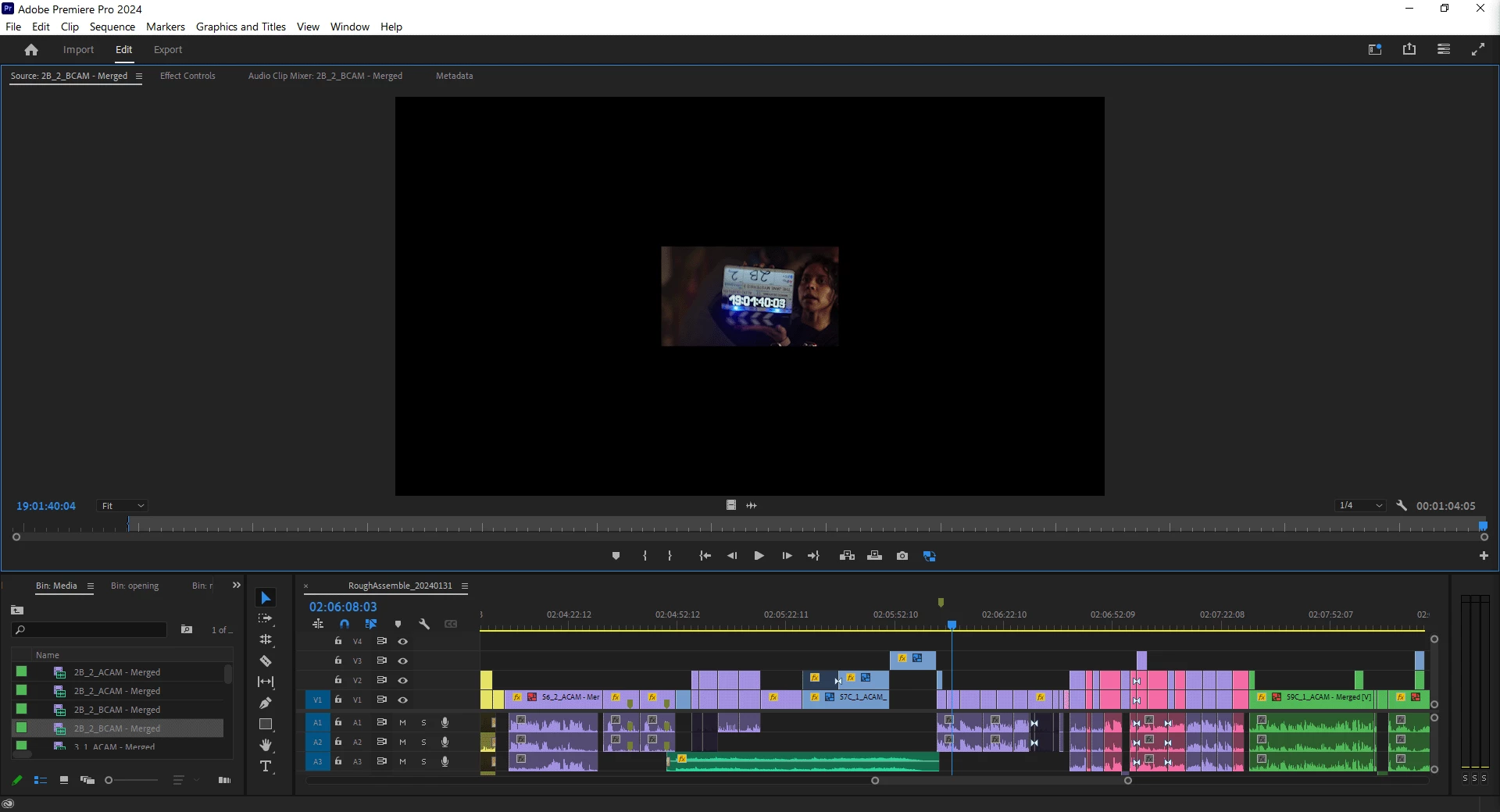

Hello! My team and I are having issues with our two recent projects incorrectly connecting to proxies and ignoring R3D files after we begin to compile the master timeline.
We work with usually 12-14 days of footage with around 5-10 scenes on each day. Footage is synced on set by the DIT with both R3D and proxy files attached. Footage is then edited offline by the post team.
When we pull a timeline from one project into another the footage begins to have an issue.
Within the timeline, synced and raw files read the proxy but 'shrink' to thier size within the media display (view attached example).
The RAWs are 8K and the proxies are 2K.
Along with this issue the RAWs/Synced files will connect to the proxy (mov) as though as it is the R3D file and states "Proxy Offline" .

  • Issue : When footage/timelines are dragged from one project into another the program reads the PROXY files as though they are the RAWs/R3D (causing a linking and scaling issue)
  • Adobe Premiere Pro version number: SYNCING project created in V 23.6.2 on DIT's PC then opened and updated in V 24.1 by the AE
  • Operating system : Windows 10 Home (22H2) [I believe this is the same across the board for all team members]

  • Actual result - Synced clips start to read the proxy files as both the HIGH res footage and proxy footage. (sometimes it says the proxy is offline and the clip believes it is connected to the high res but is replacing the raw with proxy file) Due to this the clips appear as though they are windowed within the preview (refer to image attached to the original post here)
    • When we attempt to disconnect all media and reconnect to high res we run into the issue of not being able to reattach the proxies to the synced media; even though they were synced together initally it reads as completely offline.
