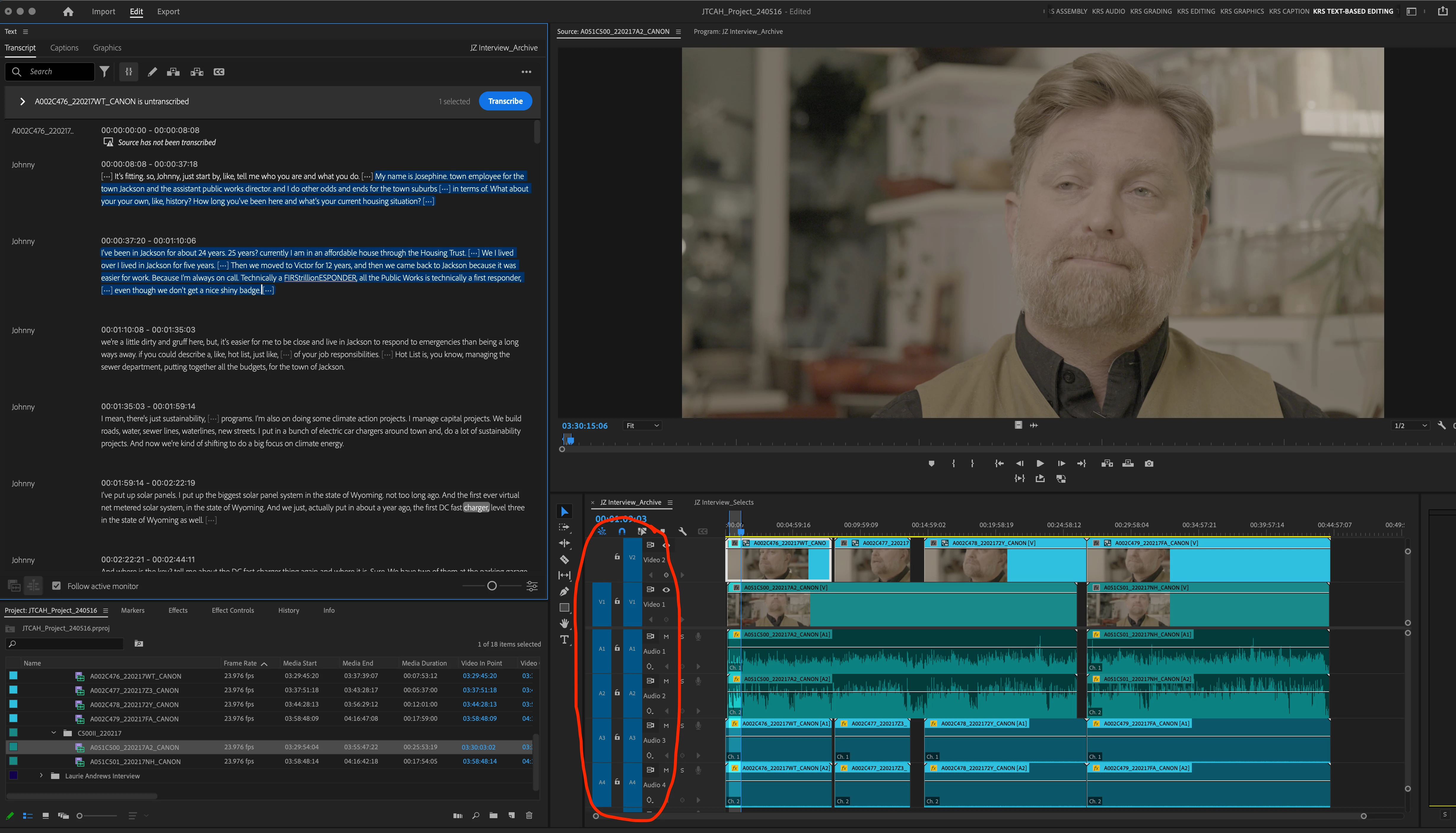

I am working in Premiere Pro 24 with the new Text Based Editing. This is a genius idea but seems to have flaws when using more than one camera for an interview.
We shoot on 2 matched Sony FX9s and I recently recorded an interview with an A and B camera (tight and wide shot)

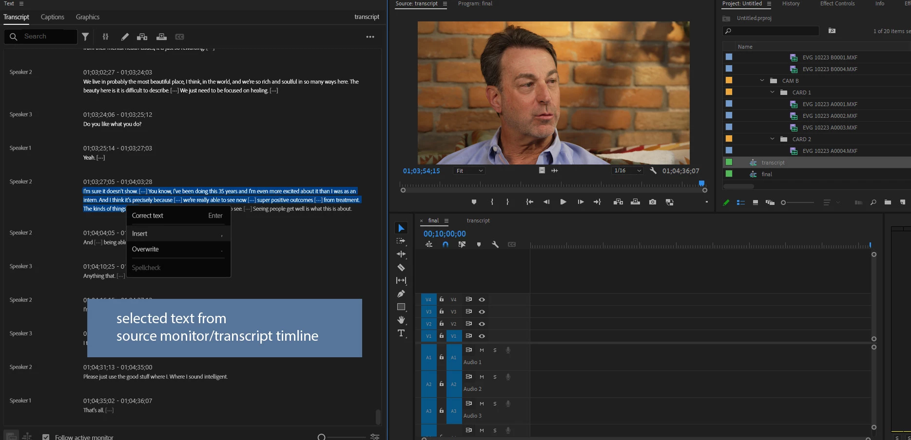

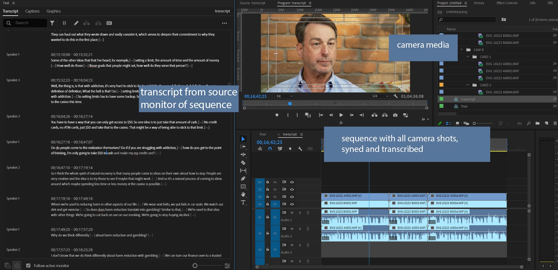

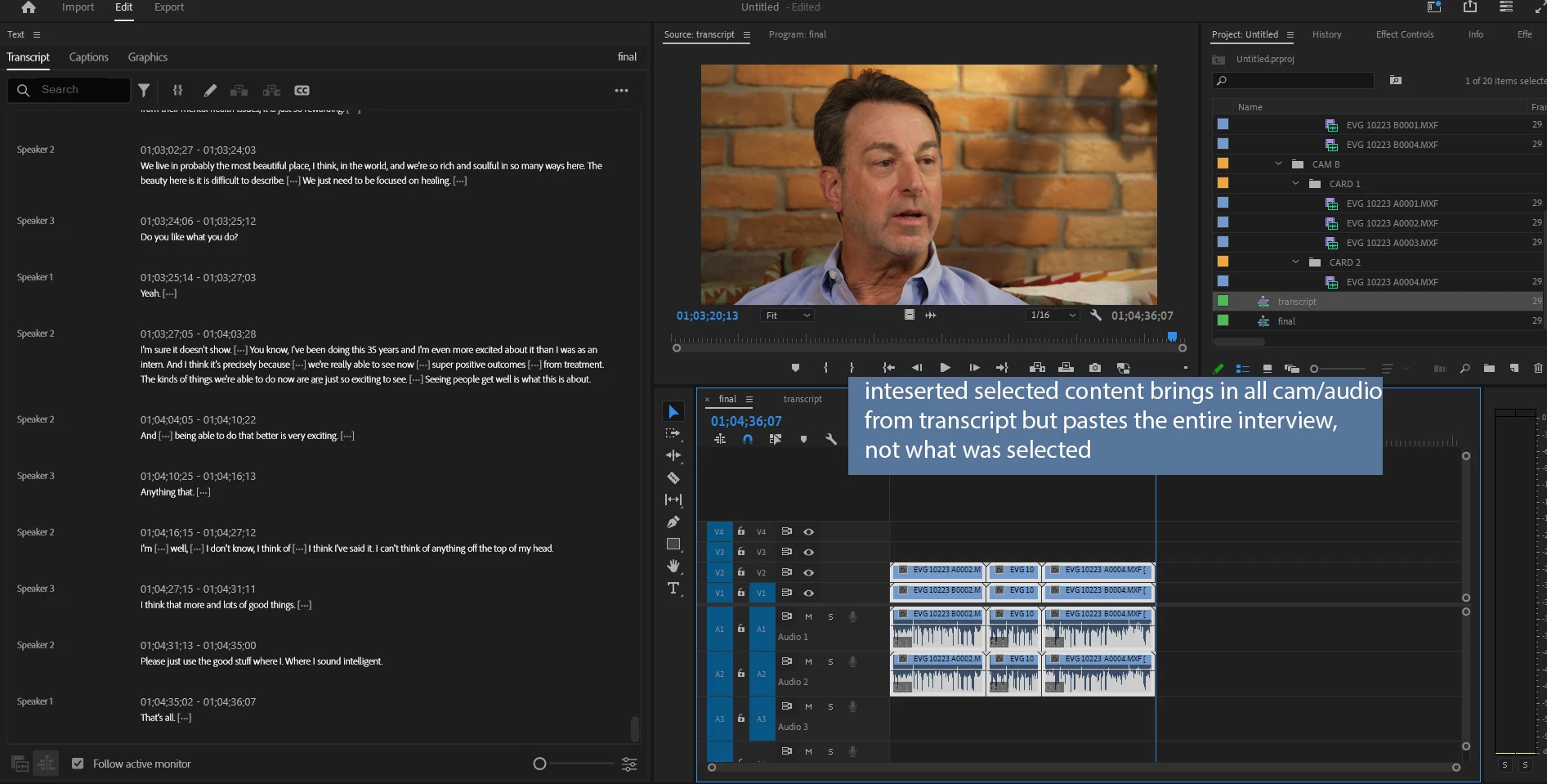

When importing into Premiere 24, the auto-transcribe works great. I laid out both camera sources onto a new sequence, synced the shots and that sequence was transcribed. However, when I went to edit the project in Text-Based Editing, it will not work correctly. When either Inserting or Overwriting the selected text into a new timeline, Premiere will paste a copy of the entire media, not just the selected section.
Mulitcam sequence didn't work either. One of the Adobe support staff suggested creating a new project and re-importing and transcribing because he thought it was a gitch.
Opening a clip in the source monitor and inserting/overriding is not an option, as then I lose my second camera altogether.
I can not for the life of me think of a workaround and it was apparent Adobe couldn't either. I can't be the only one using more than one camera for an interview. This issue needs to be addressed.
Any others with this issue or any possible solution I haven't considered?

@himynameismatt22,
Thank you for your detailed description and screenshots: very helpful.
1 - Turn on the "Automatically set in/out points" icon - the {} symbol at the top of the transcript tab. When "on" there is a faint grey box. You can mostly tell it is "off" because no in/out points are set in the source monitor or program monitor.
I agree this should not be necessary, but it is the easiest way to do Text-based editing.
2 - I tried your steps to replicate the problem when the "set in/out" is off. I selected some text, right-clicked, and clicked insert." This inserted the full clip, not just the selection.
When I used the insert/overwrite buttons at the top of the transcript tab, it worked correctly, and then the right click also worked correctly.
