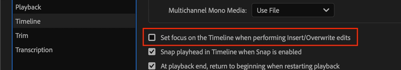

  • You may want to consider turning on the Set focus on the Timeline when performing Insert/Overwrite edits option in your Timeline Preferences, if it is not on already.  This will always activate the Timeline Panel after you perform an edit from the Source Monitor, and in my testing appears to override the Project Panel activation you're experiencing.  This may make your toggling between Source and Program Monitors more predictable in these cases where nest duplicates need to be created.
