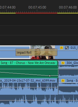

Jan 21, 2024 8:25 PM UTC
OK, but I don't see 'no red at all' as a proper goal. Or to start looking for GPU problems if a patch of red exists.
Here's a sequence I was just looking thru for another post, it only has one video layer and three audio layers, plus a transition.
