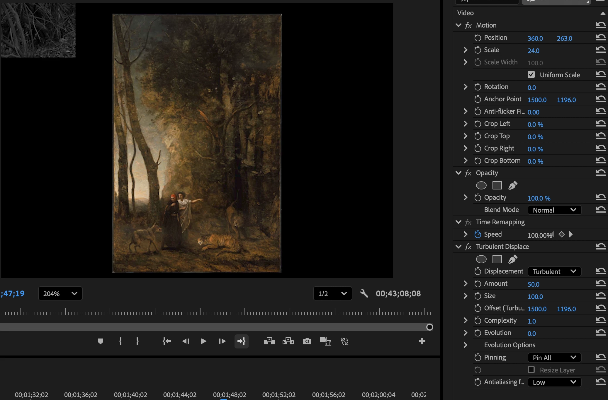

I have a number of videos using the Turbulent Displace effect. Suddenly all my projects have a broken effect, even older ones that rendered successfully just one week ago with version 25.2.3 (build 4).
Basically, applying this Turbulent Displace effect to a clip now causes the clip to jump around and resize as the effect parameters are changed. Also, all the edges of the clip are 100% digital noise/distortion. I tried deleting all the cache files to no effect. Loading old projects now have the bug during scrubbing, not just during render.
I reverted to 25.2.3(4) and everything is fine. I'll stick with this version for now.
The attached image shows the settings for the clip and the Turbulent Displace effect. Some parts of it are fine, but as the clip progresses thru the keyframes for Amount and Evolution, it starts randomly glitching and misplacing.

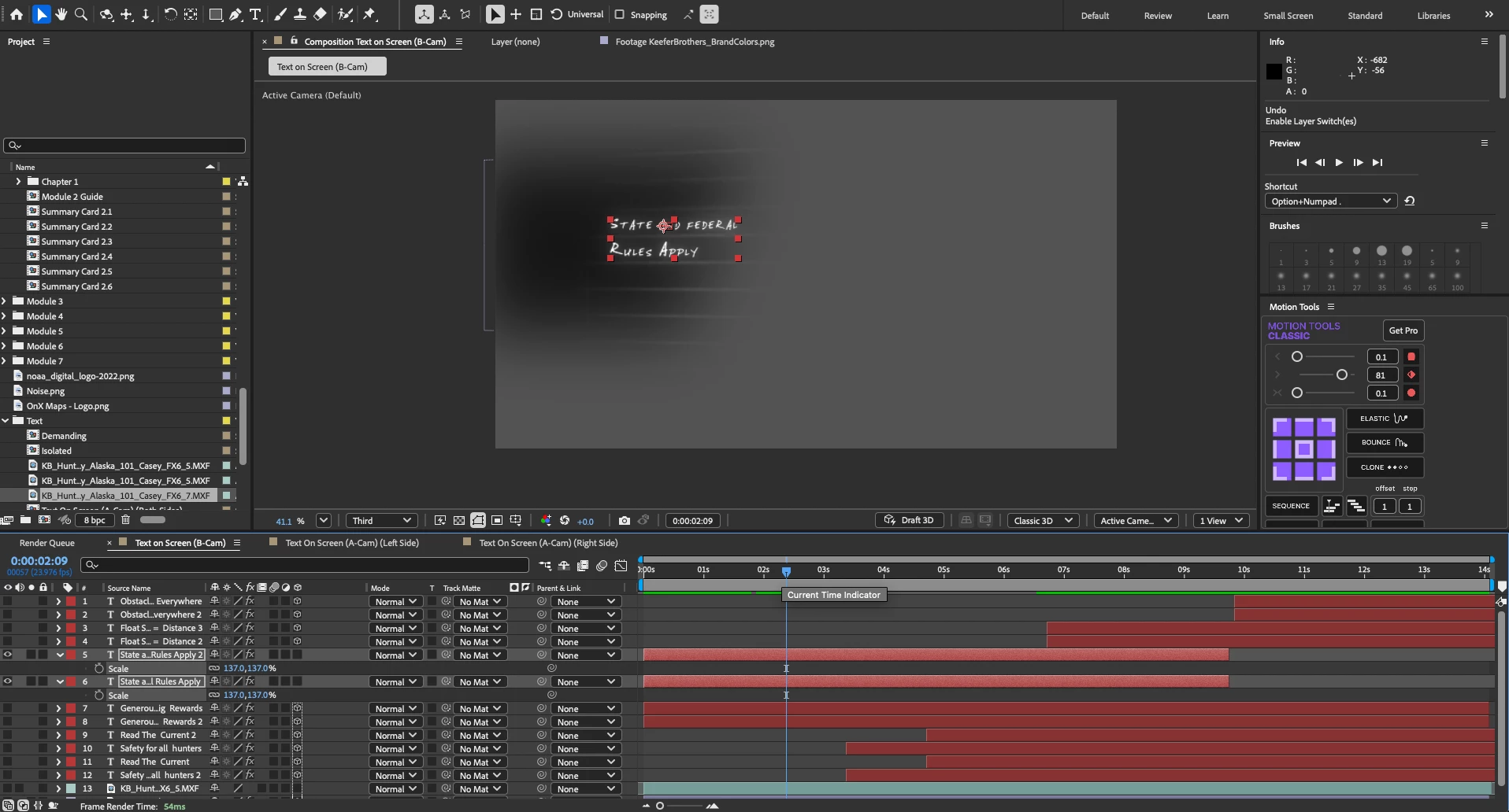

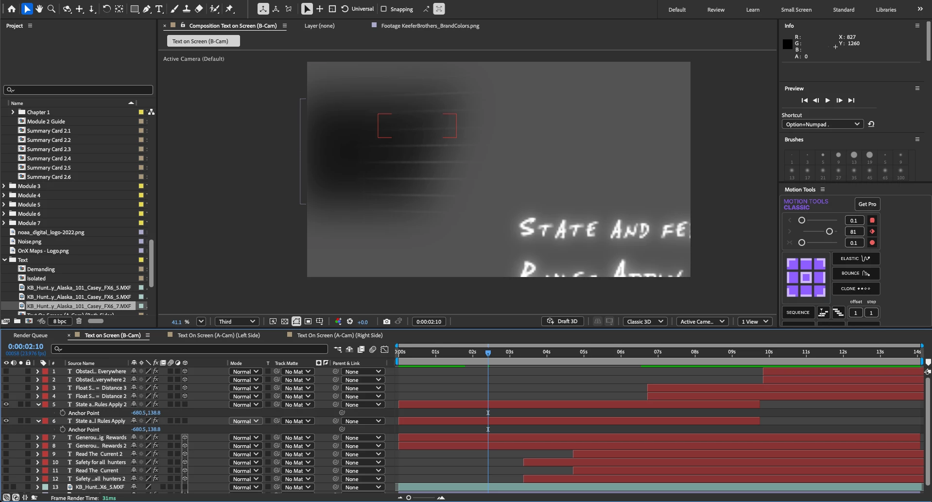

I can see that I'm not the only one having this issue... Here's two frames back to back, the second one being when my Displacement effect ends. For some reason, it's decided to completely screw with the proportions of the text, and no matter what I do (Cut it, paste it, reload, duplicate comps, everything) the Turbulent displacement effect continues to give me trouble.
I am on the newest version of After Effects and wondering when there will be a fix for this issue so that I may be able to utilize it in my projects going forward.

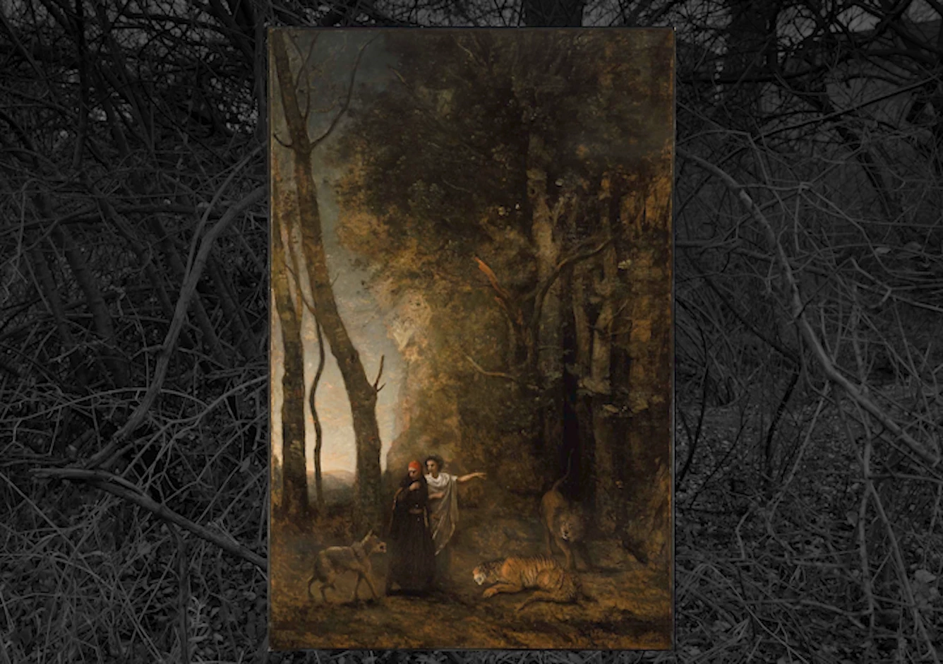

I'm in a similar boat now. I upgraded to v25.4 (Build 99) and the image with Turbulent Displace results in this resizing and displacement. Below you can see the intended layout and then what it looks like when the effect is applied to the background image. Thanks for any support with this!
