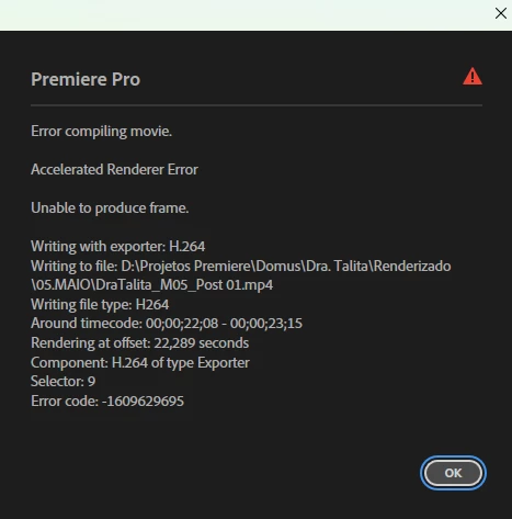

Back to the render error
What I have been doing when I have this problem is use the @MyerPj's advice to render in Quicktime and convert to mp4 on Media Encoder

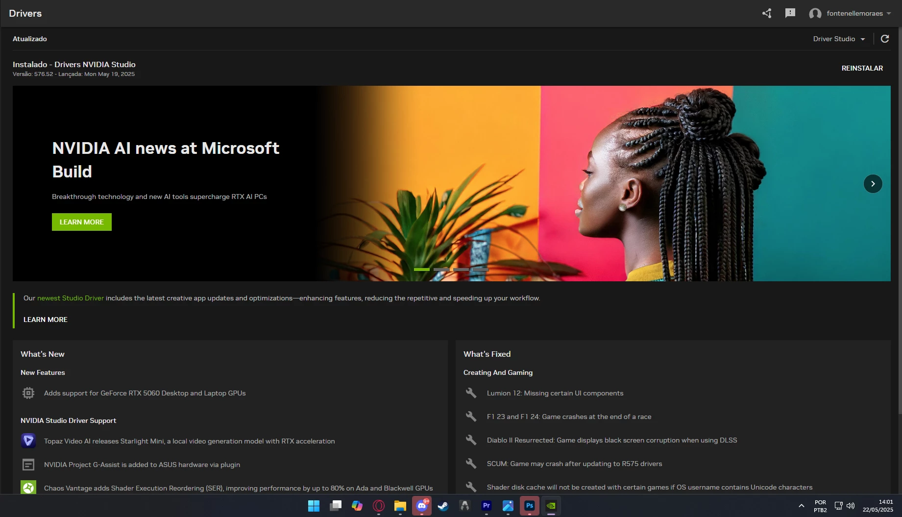

Hi @Alexander_DVA, I reseted my PC this Monday and intalled the last Studio drive version.
Alexander_DVA
Adobe Employee
Adobe Employee
May 22, 2025 2:15 PM UTC
Hi !
From the last crash report you sent it looks like you are crashing in the nvidia driver - can you try updating to the current studio driver:
https://www.nvidia.com/en-us/drivers/details/232934/
