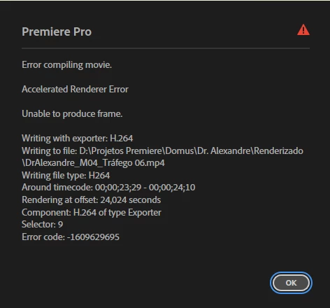

I have been having very poor performance on my Premiere. Specially after the update. My PC specs are:
MB: Gigabyte B760M AORUS ELITE
Video: EVGA RTX 3070 Ti FTW3
CPU: Intel i7 14700K
Water Cooler: C3Tech FC-W360RGB
RAM: 64 GB DDR5 Kingston Fury RGB 5600 mhz
M2: XPG S70 Blade 1TB
SSD: WD Green 120 GB
SSD: WD Green 240 GB
PSU: Gamemax GX1050 PRO
Gabinete: Gamemax Lucent
Coolers: 6 ARGB Rise Mode Laser 120mm
I have some projects that keep crashing every 5 minutes. It's very annoying problem and I don't know what to do. I clear my cache everyday, already using proxyes to make it more smooth, but it's not working

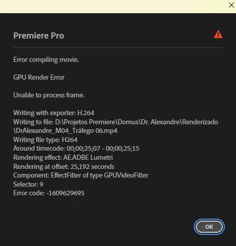

Intresting discover, with lumetri but no Look at creative tab, the video rendered.
Apr 9, 2025 8:50 PM UTC
deleted the adjustment layer and drop the lumetri on the source, tried to render, same issue
Apr 9, 2025 8:47 PM UTC
Guys i've been having this issue now, it was doing it before, but now it's seems to be worts
It's a fresh project made in the new version, there is no special effects, only a lumetri in a adjustment layer
