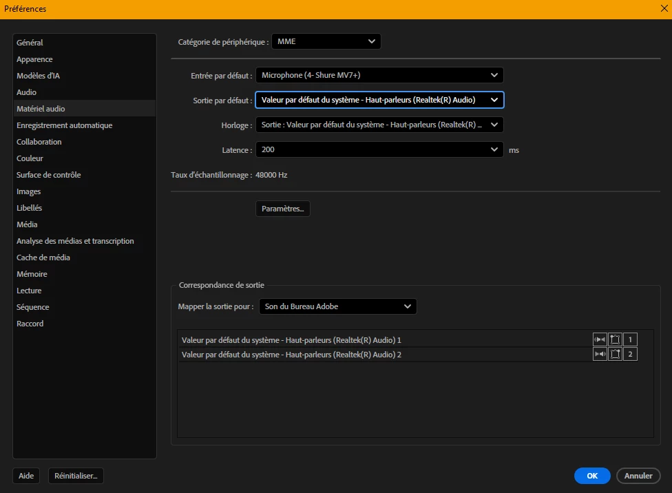

I don't have a built-in-mic since I'm on a desktop pc and not on a laptop but I have tried with another microphone from my headset and the result is the same, mic is recognized but doesn't create any clip.
I'm using 25.4.1, I was using the 24 version and met this bug, I have uptaded to 25 because of that bug but finds out that it's stille there.
Here's my Audio Hardware Settings.
I have tried in a new sequence, even in a different project but no, still the same.
Idk if it's important but Premiere is installed on my SSD which is C:/ while my Scratch Disks are on a separate HDD which is A:/.
