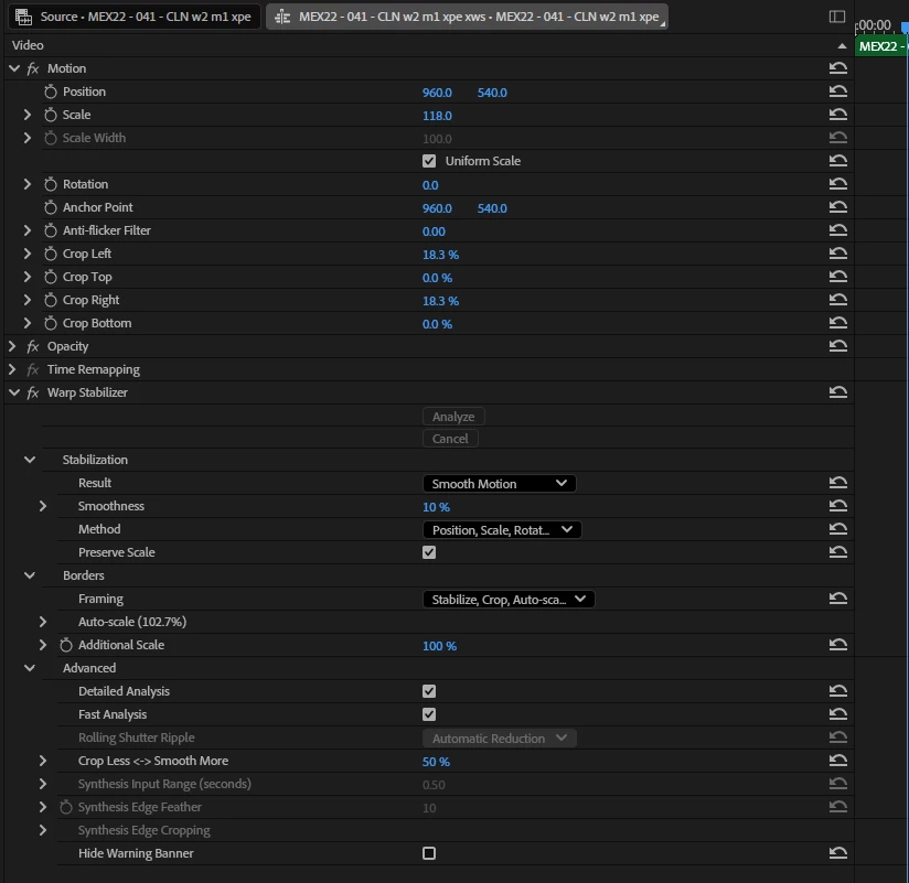

Stabilization Settings
I am not using any subspace warp - all position and scale, and my percentages for stabilization are low.
I have attached a screenshot of my stabilization settings, but here they are again:
| Motion | |
| Position | 960.0, 540.0 |
| Scale | 118.0 |
| Scale Width | 100.0 |
| Uniform Scale | Enabled |
| Time Remapping | |
| Warp Stabilizer | |
| Result | Smooth Motion |
| Smoothness | 10 % |
| Method | Position, Scale, Rotation |
| Preserve Scale | Enabled |
| Borders | |
| Framing | Stabilize, Crop, Autoscale |
| Auto-scale | (102.7%) |
| Additional Scale | 100 % |
| Advanced | |
| Detailed Analysis | Enabled |
| Fast Analysis | Enabled |
| Rolling Shutter Ripple | Automatic Reduction |
| Crop Less <-> Smooth More | 50 % |
| Synthesis Input Range (seconds) | |
| Synthesis Edge Feather | |
| Synthesis Edge Cropping | |
| Hide Warning Banner | Enabled |

Examples
I have included two examples of what's happening, as well as screenshots of the frames prior to any effect being put on plus the warp settings.
