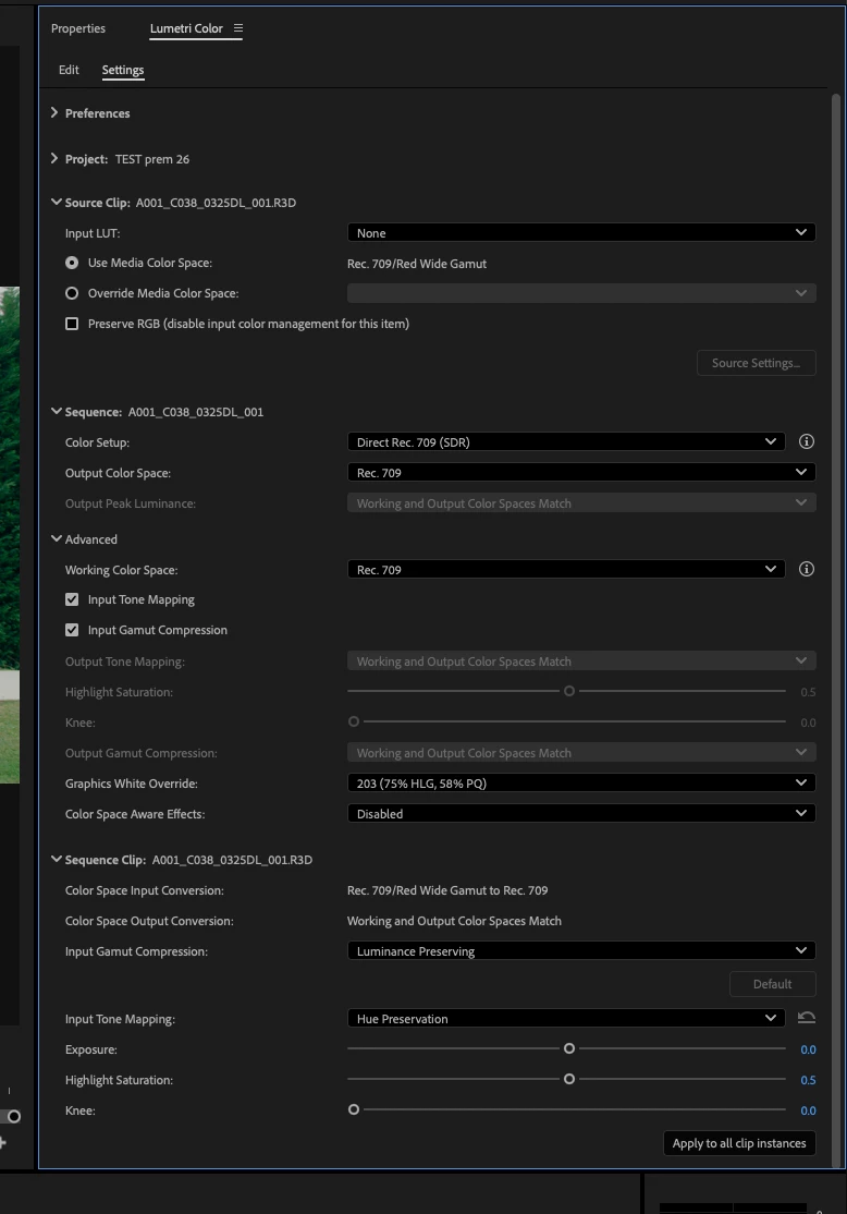

When importing R3D files from RED Gemini in Premiere 26, the Output Transform Settings change the gamma curve from Log 3G10 (which is what it's meant to be) to BT 1886
Mac OS Tanhoe and Premiere 2026 26.0.2 build 2. When I import RED Gemini footage the Output Transform Settings gamma curve gets changes to BT1886 from Log 3G10 meaning I can't preview a log image at all which is no good for grading. This is in the raw video settings tab. On the same shoot we used a RED Komodo shooting R3D too and it imports and the gamma curve sticks to LOG3G10 as normal. I installed Premiere 25 and imported the footage and it worked fine so it definitely seems like a problem with Pr 26

    If you want a log-view, you need to set for that view.
    You have Direct Rec.709 set for your sequence, and input tonemapping is on. If you want to stay with Rec.709, then ...
    First, uncheck the input tonemapping in the Sequence …
    Second, if you need, check the “Preserve RGB” option to disable CM for this item above in the Source Clip setion.

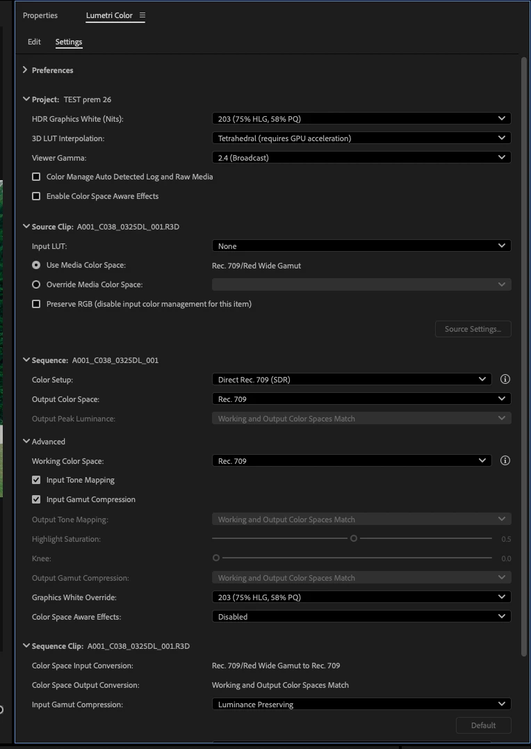

    What is your total color management set to? Screen grabs of the entire Lumetri Settings tab ... the tab named Settings ... would be of best use. That’s where all CM lives now, and we can see if something is set to cause this or if it’s being a bad app for you.
    Many of the CM controls are interactive dependent on otheri CM control settings, and that can catch one by surprise at times.

    Hey, thanks for the reply! Have added a couple of screenshots of the source and project colour settings from the Lumetri panel here.
