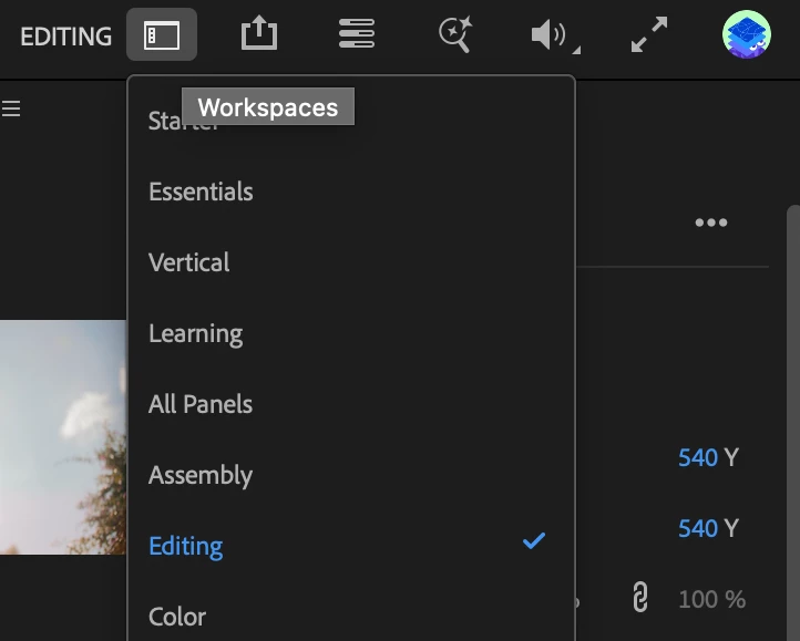

    Hi ​@tvM,
    Welcome the Premiere forums and thank you for reporting this occurrence. We appreciate you providing such extensive detail. To better assist you, please see our follow up questions and a suggestion to try:
    • How are you saving the workspace? Are you saving using the top bar menu, or are you using the Workspace button in Premiere?
      • If you are using the button (screenshot attached), please try saving your workspace using the top bar menus (Windows > Workspaces), and let us know if there is a different result or not.
    • If possible, could you send screenshots or a screen record?
    Best,
