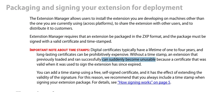

As @Softmatic GmbH and @Alex White have pointed out, it is possible to create a ZXP by omitting the TSA, however this comes with an expiration date, though "supposedly" far in the future, from the Adobe documentation in SigningTechNote.pdf sounds like it could break sooner without warning:
