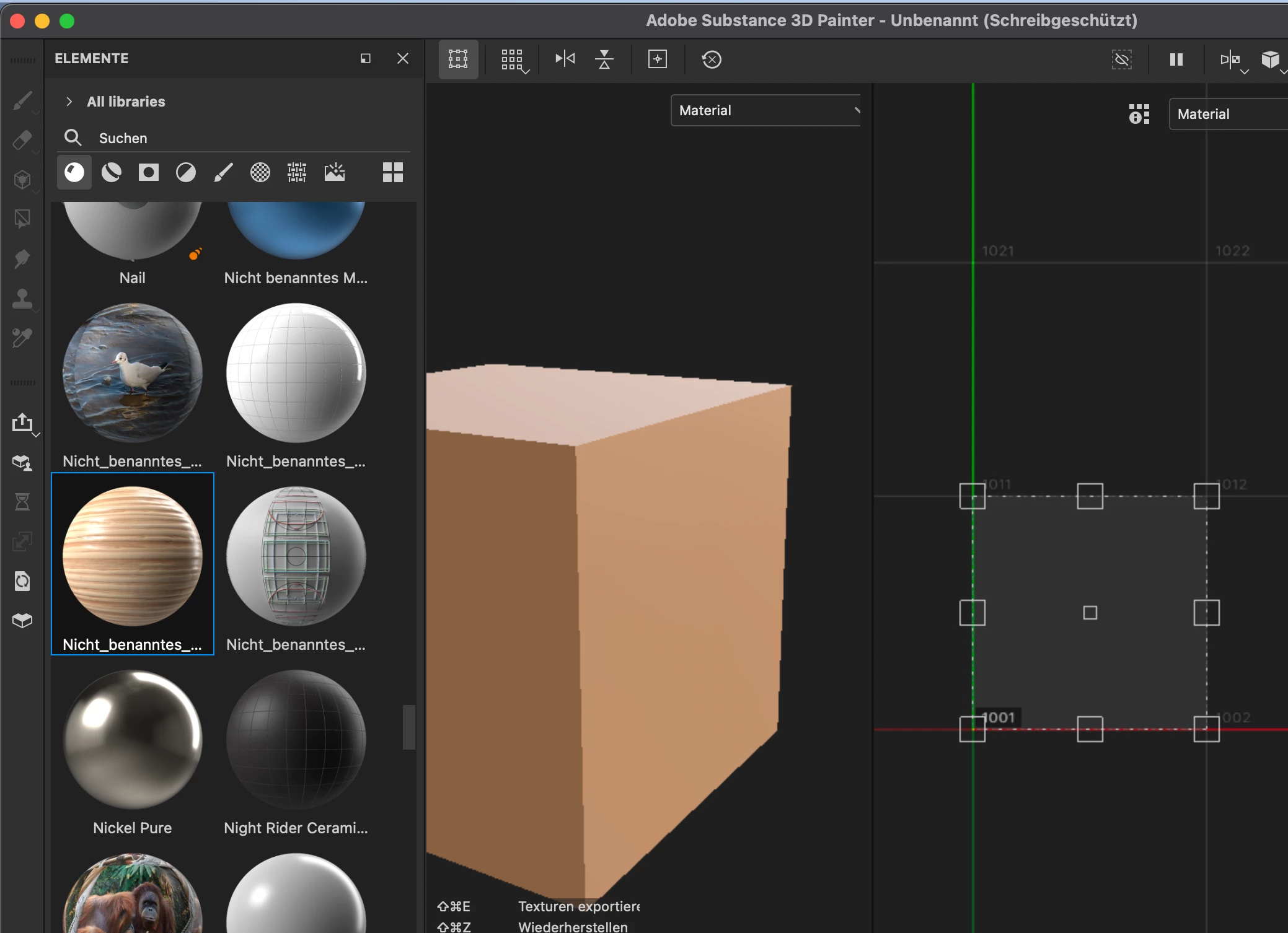

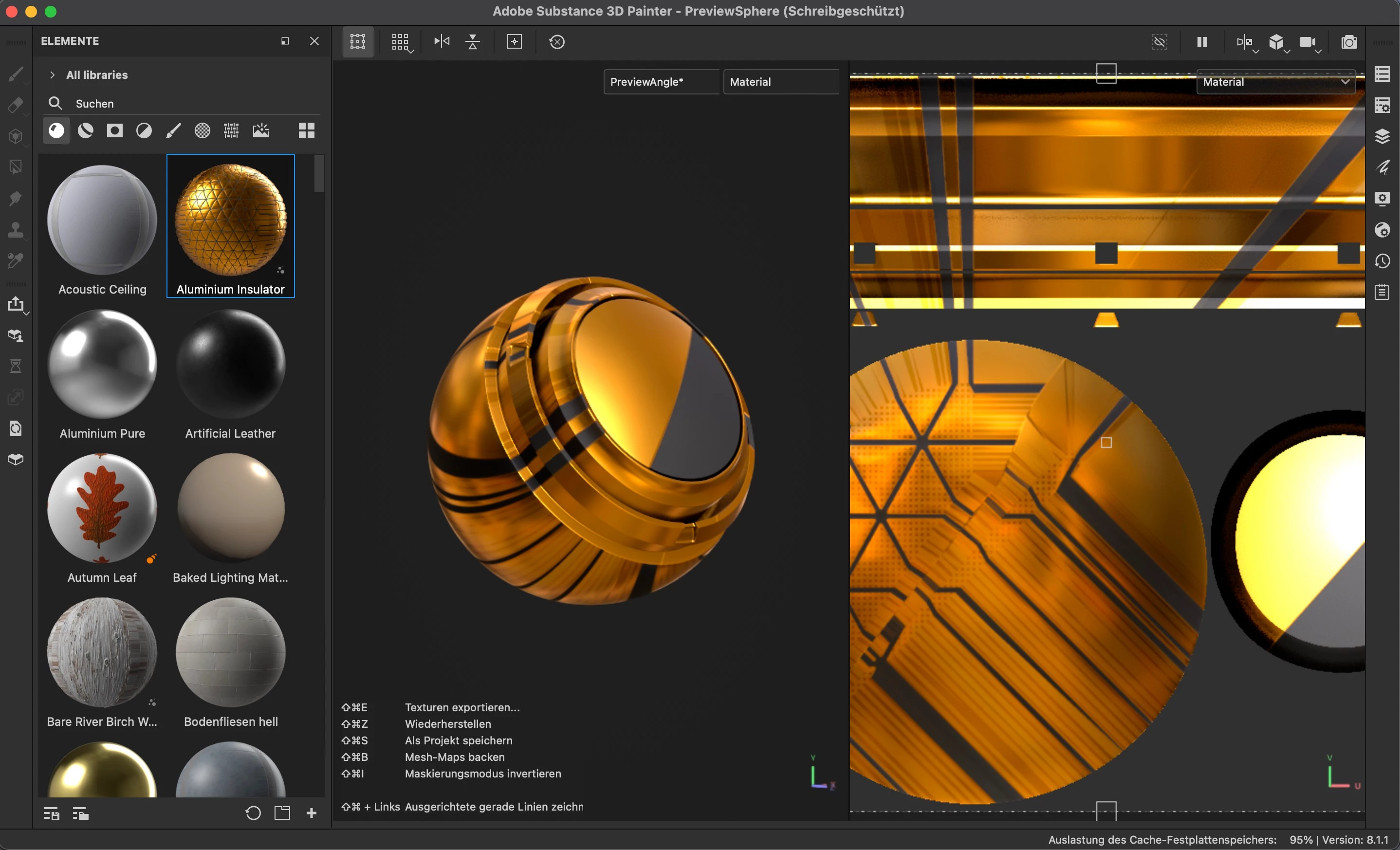

First i thought i have only a problem with the Update of Painter 8.1.1 because materials placed on mesh looks destroyed. But now i realize ive also a problem with the Update of Stager 1.2.2.

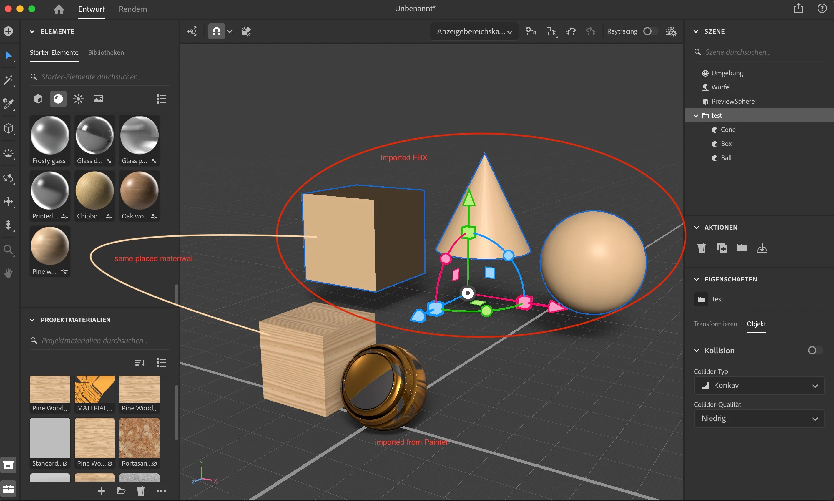

Different from the previous version, when i place material like wood on the imported mesh (fbx), the mesh just gets a color but no structure. Also from Painter imported mesh is corrupted.
I am working with M1 MBP 16GB Ram.
Is there any help except downgrading Stager back to 1.1.2 and also Painter from 8.1.1 to 7.4.3?

    But i dont like to use the old version of Painter (7.4.3) with my M1 Macbook Pro. As i saw that there is a newer update to Painter 8.1.3, i thought this could solve my problem
    I updated to this latest Version and again the sam old Problem:
    I can´t place a Material on my mesh (FBX-File from Cheetah 3D) which was possible with 7.4.3 - i just see the main color of the material! The 2D view just shows a grey square then.
    When i try an OBJ-File with the same mesh (from Cheetah 3D) it works fine.
    The mesh i tried was just a simple cube.
    If you want, i can send you the FBX-File and the OBJ-File for comparison...
    I need a solution. What can i do to avoid downgrading or nor using fbx-Files anymore?

    If you don't mind, could you send a copy of your Stager scene you have in your photo?
    I can pass it onto the team and have them look into the issue you're running into.

    Jul 6, 2022 2:37 PM UTC
    I spent the whole day on testing different Versions... What i can say for sure is painter 8.1.1 doesnt work well on my M1 MBP, but version 7.4.3 works as it should.
    I discovered also that Stager has a problem to place Material onto some imported fbx files except i go the way through Painter. Importing fbx directly in stager 1.1.2 i had different relults. FBX from Adobe/Substance assets worked well with placed Material. FBX-meshes made in Cheetah 3D imported in Stager showed only color. Same file imported as OBJ worked well. After w whole day of trying all my FBX files will be sent from Painter 7.4.3 to Stager.
