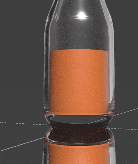

    enamic5Author
    Feb 16, 2023 9:54 AM UTC
    Hello.
    thank you for your reply – yes - your test pretty much shows the issue with the ground surface, showing a wrong refelction, as soon as you have refraction within the bottle. even the water droplets texture I used got ignored. It seems to be some kind of hierarchy on what part of the reflection is built before considering other parts of the object.
    here is the file – https://we.tl/t-ojqXiWKcHW
    thanks for your help.
    Stefan.
    JMathews
    Feb 15, 2023 5:24 PM UTC
    Would you be able to share this scene or a simplified version so we can see how it's setup?  If not, can you please describe in detail how it's configured?
    • Is the ground reflection from the ground plane in the environment or is that a model?
    • What types of material and texture settings are you using on the juice to get the bubbles?  Is it displacement?
    • Is the juice intersecting with the glass model, or fully inside?
    I think from my testing you may be using a reflective object which is giving me different results than the reflective ground plane.  I can bring this up to the rendering team for sure.

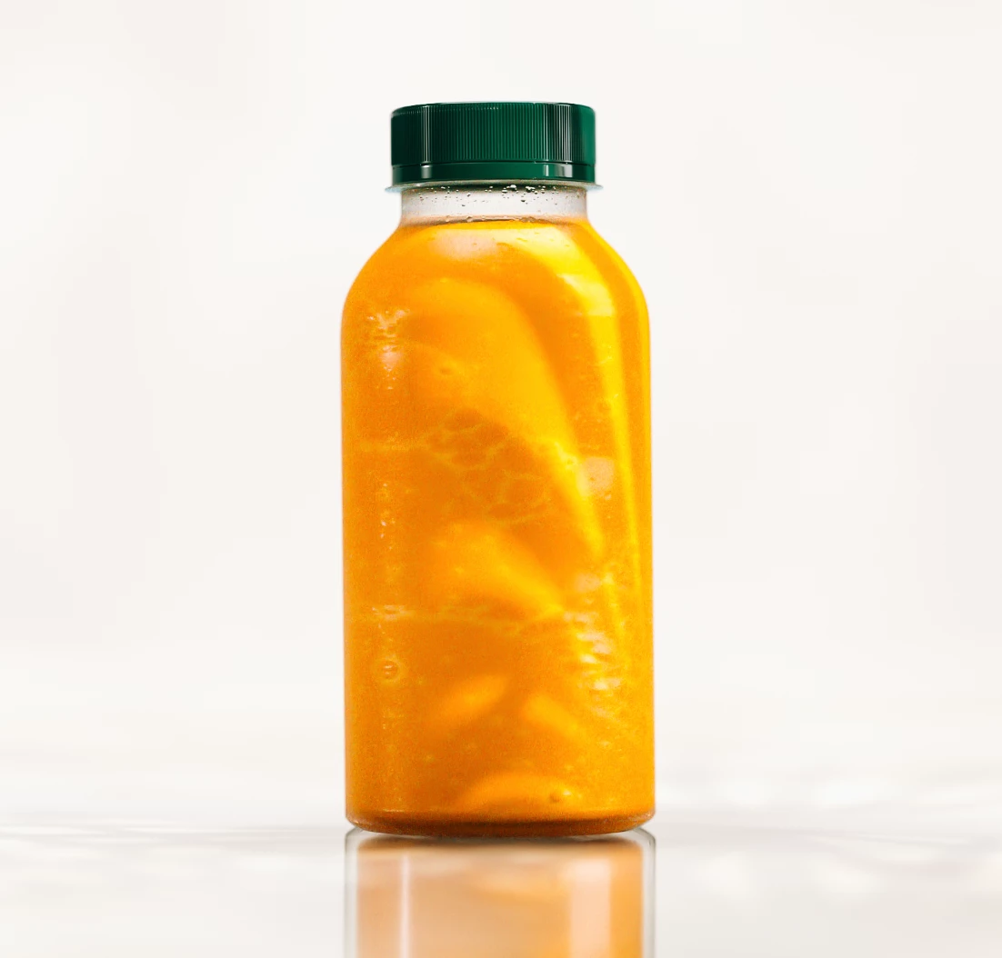

    Hello and thank you.
    If you have a look at the picture you can see that the contents of the bottle visually wrap to the outer edge. You can also see the little water bubbles , reflections and the shadow on the outside of the bottle.
    On the table reflection however all of these things are missing and reduced to the basic, matte orange fill and the glass bottle. The table reflection shows none of the in bottle refraction or other details.
    thank you
    Stefan.
