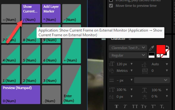

BTW: I use the "/" in the numeric keypad as it's the same in After Effects

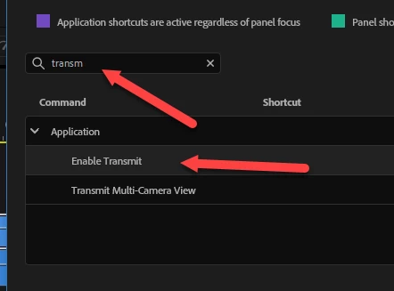

side issue - @MyerPj I set a keyboard shortcut to the transmit enable, and it does indeed toggle on and off transmit so this helps me out a whole lot as I frequently do this thank you!

Yes, that's right. It might have taken your update to the prefs, just open it up and check. I believe that error comes up whenever you press the <OK> button, even if no changes have been made. We could use an <Apply> button there, but the prefs would have to be a non-modal dialog to gain the maximum. But even saving more than one pref on different pages, would benefit with an <Apply> button. FWIW: Here's how I have that pref setup, while using a keyboard short:

BTW: You can create a keyboard shortcut to Enable Transmit:
