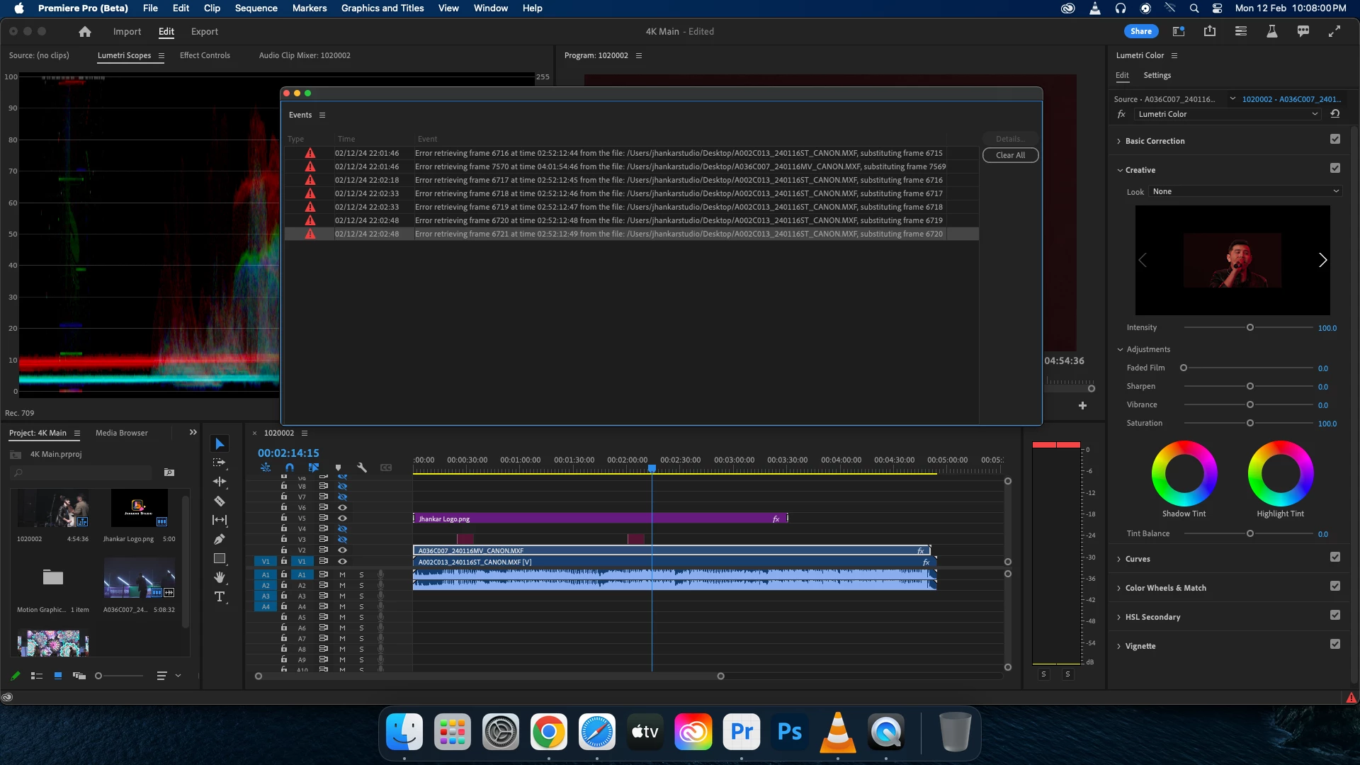

Error Retrieving Frame
Show Event massage - Error Retrieving Frame. Please Solve This Problem as soon as Possible

Hello, had the same issue with converted .mxf files.
Here is what our strategy was that seems to fix that issue:
1. Shift+Premier - delete cache files.
2. Do not open projects, just Premier and delete   All cache files through preferences
3. The most important: Delete the local user account Windows cache by the folowing steps:
Initial Steps (Enter Recovery Environment):
  1. Enter Recovery Environment (If you are unable to get into the recovery environment via a menu, you can turn off your system during the initial boot when the Windows logo is on the screen and the dots are circling. Do this at least twice and you'll see the message "Starting Automatic Repair").
  2. Once the recovery environment loads select "See advanced repair options", then "Troubleshoot", then "Advanced options".
Method #1 (Via Command prompt - assumes basic command prompt knowledge):
  1. Click "Command Prompt".
  2. Change directory to your boot drive if necessary (for example, type c: and press <ENTER>)
  3. Type "CD %windir%\system32\config\systemprofile\appdata\local\microsoft\windows\caches <ENTER>
  4. Type "DIR <ENTER>" and make sure you are in the right path. You should see one or more .db files -- usually just cversions.3.db. If there are no files in this directory see the addendum below.
  5. Type "DEL *.* <ENTER>"
  6. Reboot and test
Method #2 (Via Safe Mode and File Explorer - may require adjusting permissions):
  1. Click "Start-up Settings" and "Restart" to reboot the system and get the option to enter Safe Mode.)
  2. At the Startup Settings screen press "4" to boot in Safe Mode.
  3. Log into your administrator-level account.
  4. Open File Explorer and browse to %windir%\system32\config (example: c:\windows\system32\config)
  5. Gain access to systemprofile (you may be able to just double-click it to gain access)
  6. Drill down to %windir%\system32\config\systemprofile\appdata\local\microsoft\windows\caches
  7. Delete all files inside caches
  8. Reboot and testFinally, create NEW Premier Project and import old project assets (sequence by sequence).
Hopefully, these steps will help.

Confirming: Every single piece of media that matches that description worked fine in previous versions of PPro, but now all display similar behavior?
Do you import the media directly from a camera card structure, or do you move the .mxf files to other directory structure(s), first?
Do you use PPro's Media Browser to import the media?
Feb 13, 2024 4:31 PM UTC
Camera - Canon XA70
Format - XF-AVC
1920*1080 / 50fps
shutter speed - 1/60
Bit rate - 45mbps
