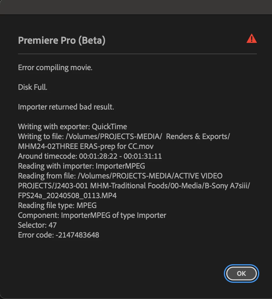

The last sudden eject triggered this attached message.
Disk full???
For the record, the remaining disk space for the media and projects is over 62Tb.
So...not that.
