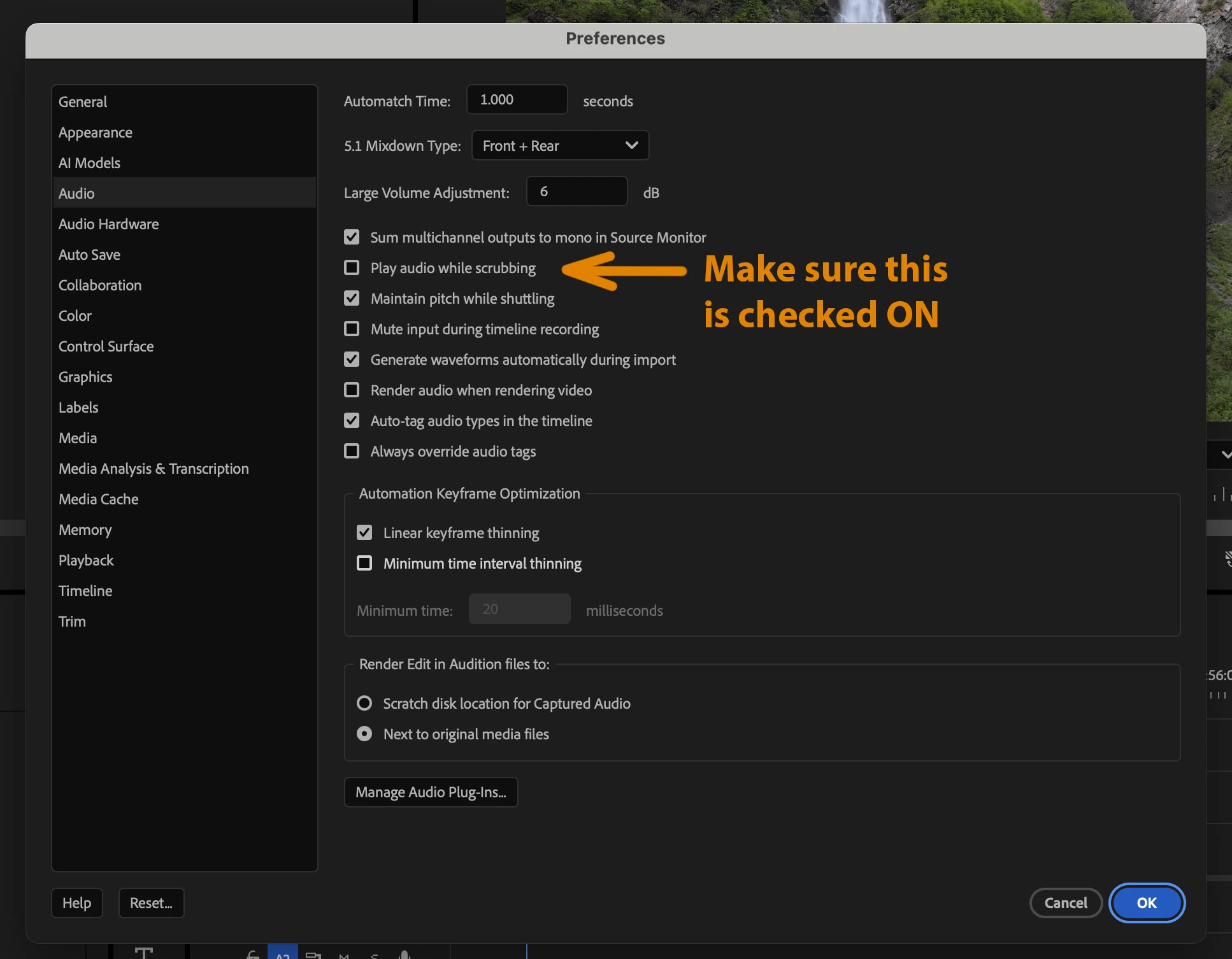

    UPDATE: The fix for this problem has been verified on mac and win at Pr25.2xBeta050. Please update to that build or later when you can.
    Thank you @Lounger and everyone else who took the time to report this to us. We have found the root cause and a fix is on the way. For now, as a workaround, please make sure the Audio preference "Play audio while scrubbing" is checked ON and then restart PrPro after checking it on or off. See the attached image for clarity.
