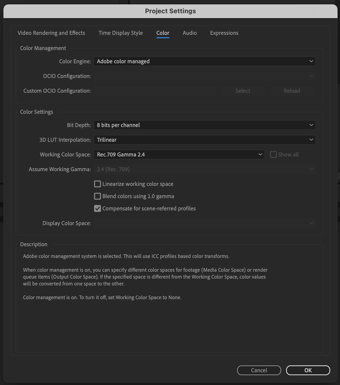

First, in your Project Settings, go to Color and make sure the Color Engine is Adobe color managed. Make sure Working Color Space is Rec.709 Gamma 2.4. Checkboxes underneath should be unchecked except for Compensate for scene-referred profiles.

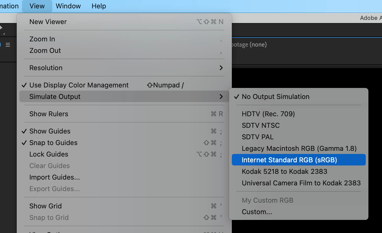

Then when you're working in your composition, go to View > and turn on Use Display Color Management. Then go back to the View menu and go to Simulate Output and select Interet Standard sRGB. Then from there on in your comp, everything you see in your viewer will look idential to what gets rendered out.
Adobe's viewers in the app are meant to be on sRGB displays. This workaround presents the colors/contrast to you on your better than sRGB display in a correct way. After Effects has a fix, Premiere does not.
