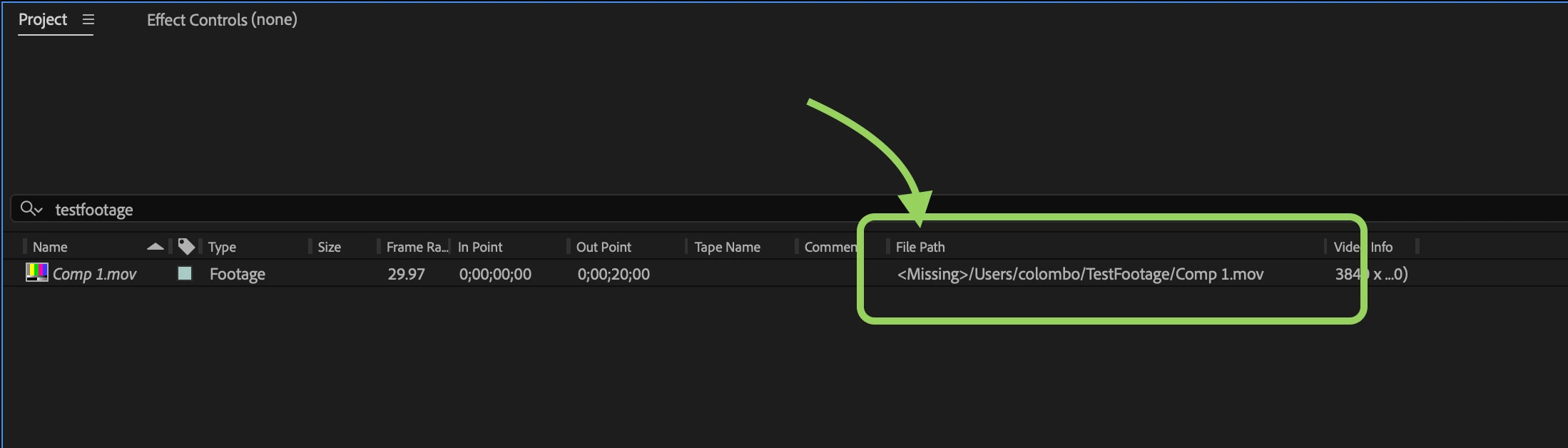

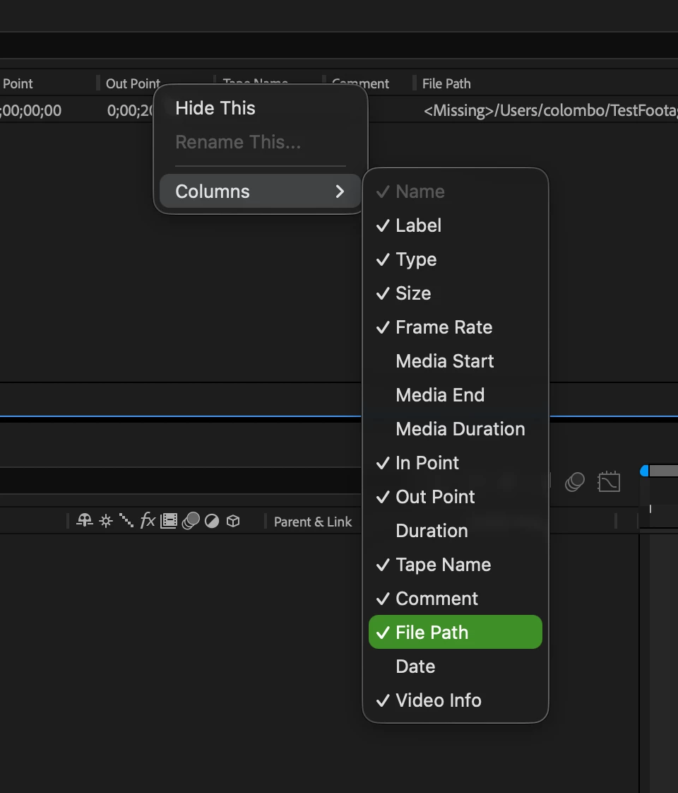

    Hi ​@Professor Venezia,
    Thank you for reporting this issue. You should still be able to search by file name if you have the File Path column enabled in the Project panel. Do you have that column enabled?
    You shouldn’t need to make the Project window this wide (this was only to show the full path is shown.)
    Please let us know if this works for you.
