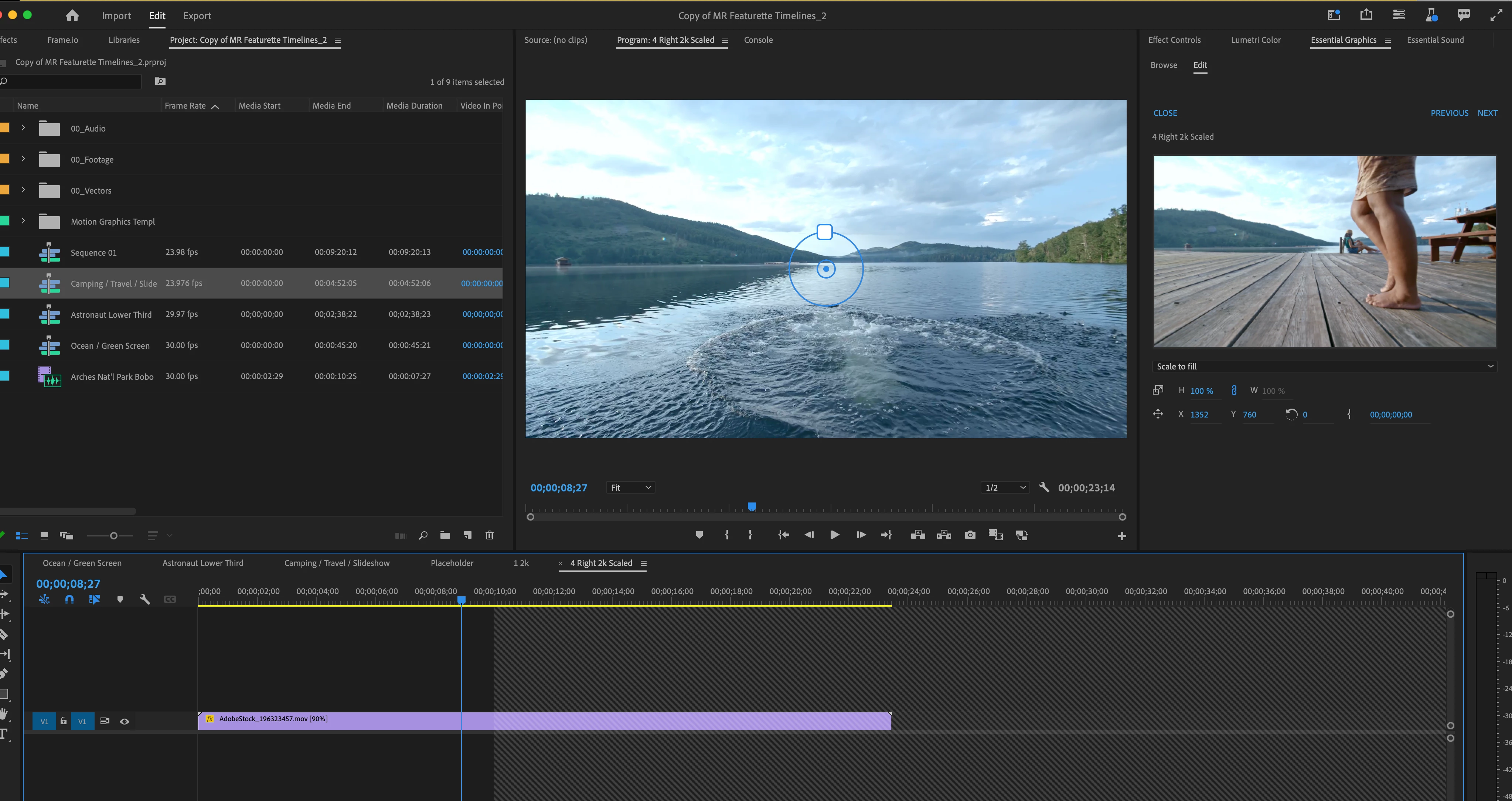

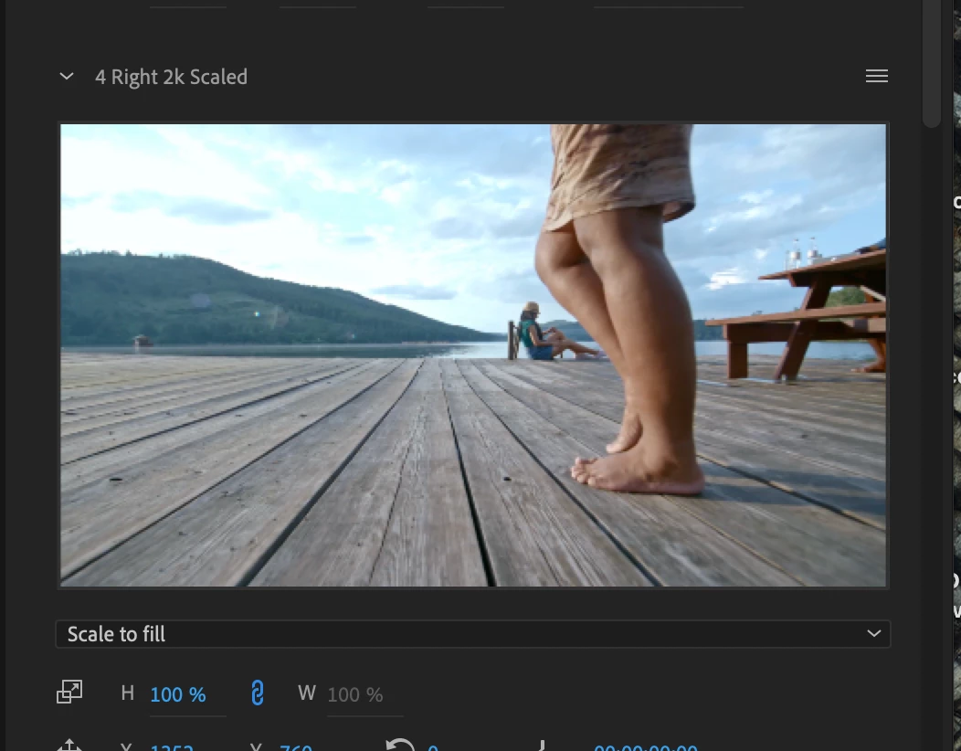

This is not exactly how media replacement works in Pr. In Pr, there is a sequence created at the fixed dimensions of the media replacement control. Any replacements are inside that sequence, and they can be simple or complex content, just like any sequence. But most importantly, all compositing for this sequence is managed on the Pr side and AE code doesn't know anything about it. It just always gets back a rasterized image at exactly the dimensions of the MR control. So this means there is no expression access possible that looks inside the replacement that happened in Pr.

Unfortunately, the way that this works in Premiere is not the same as the way as it works in After Effects.
As you mentioned, in AE there is a comp that is created that we call the "Embedded Comp" in the Media Replacement folder.
But in Premiere Pro, this replaced media is added to a hidden nested sequence that is not listed or named in the Project Panel.
The media is accessible to the user by double-clicking on the thumbnail for the Media Replacement control in the EGP. This nested sequence displays the same name as the Media Replacement control. There is no new name created for the replaced media like in AE.
