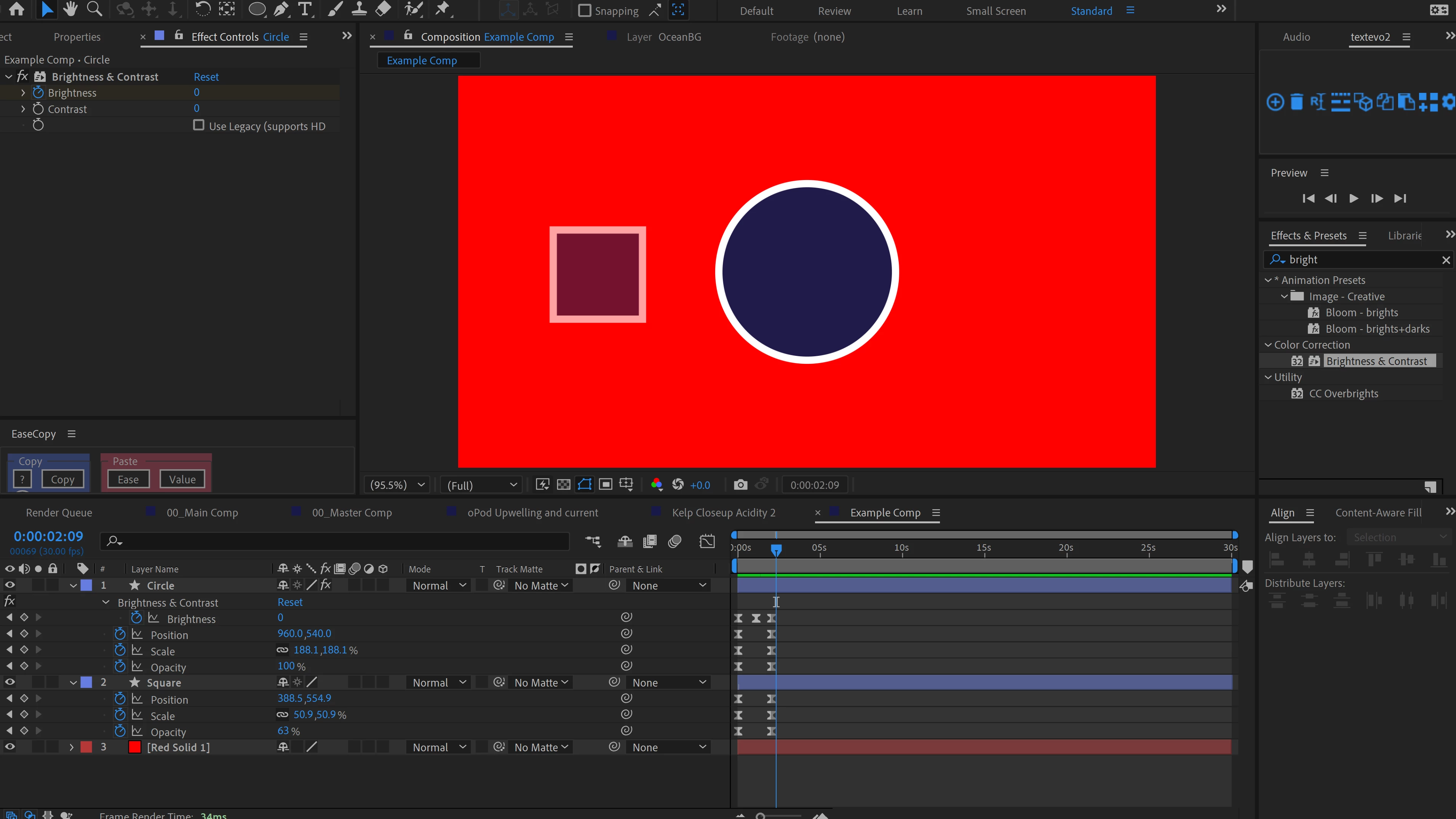

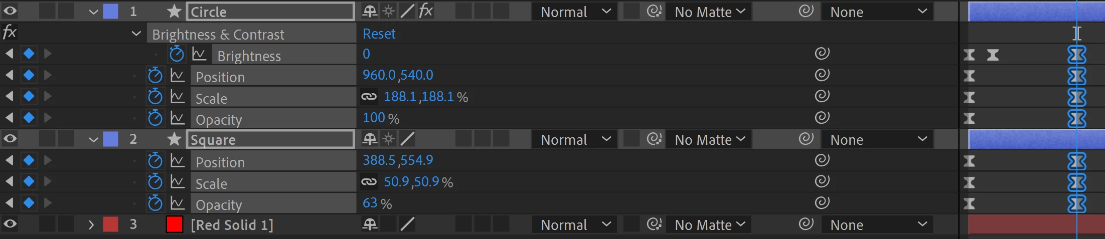

In this example, lets say we have multiple layers, each with keyframes on multiple attributes (position, scale, transparency, and an effect attribute like brightness). These keyframes line up with their start and end points across layers, but some attributes such as brightness have one additional keyframe in the middle. Lets call all of these keyframes a group.
Now imagine that I want to extend the end point across to 5 seconds. A simple task in such a simple example, all I'd have to do is select all the end keyframes and drag them across to my playhead.
Easy done. Although I will have to move that center keyframe as well, if it doesn't rove across time.
But now imagine that this composition contains 200 layers, each with complex interractions, multiple groups of movements all overlapping with one another, even within singular layers. This becomes an absolute nightmare to retime if you have to make changes to timing.
You have to go through layer by layer and make sure you're selecting the groups properly. You'd move some layers (especially precomps that already contain animation), and leave some layers where they are moving only their keyframes, extend the timing of only select portions of the groups, and rearrange any middle keyframes according to the individual attribute's needs, all the while trying not to disturb other motion groups and not to miss any keyframes that should live in the group you're moving. Tedious at best.
