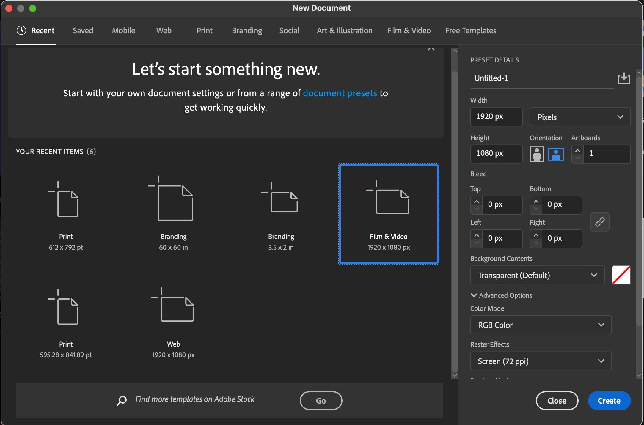

    Feb 4, 2026 1:11 PM UTC
    The problem with your AI file is that you only have one Comp-sized artboard. If you use the Create New feature in Illustrator and pick film and video you’ll get two Artboards. One will be comp-sized, the other will be huge.
    I double-clicked the second artboard to show both, and created a shape outside the first.
    Import as a composition, and you will avoid the cropped at the edge of the comp problem when you only have one artboard. That is all there is to it, and it has been a feature since importing as a composition became an option.
    I’ve uploaded a file. Give it a try.

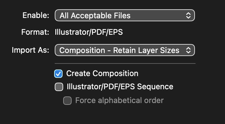

    thepixelsmith
    Jan 30, 2026 3:17 PM UTC
    Did you use Import as Composition setting or the Composition - Retain Layer Sizes option?
    The Retain Layer sizes import choice will respect objects outside the bounding box.
    But theres a limitation to this.
    Your illustrator file needs to be made with two art boards in the same physical place. The first art boards sets the import dimensions while the second insures that any artwork that is outside the primary art board doesn’t get clipped.
    This is the way all of Illustrator’s Video Presets have always been constructed.
