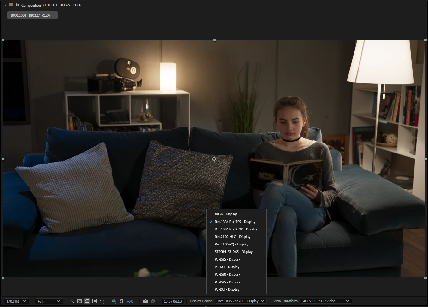

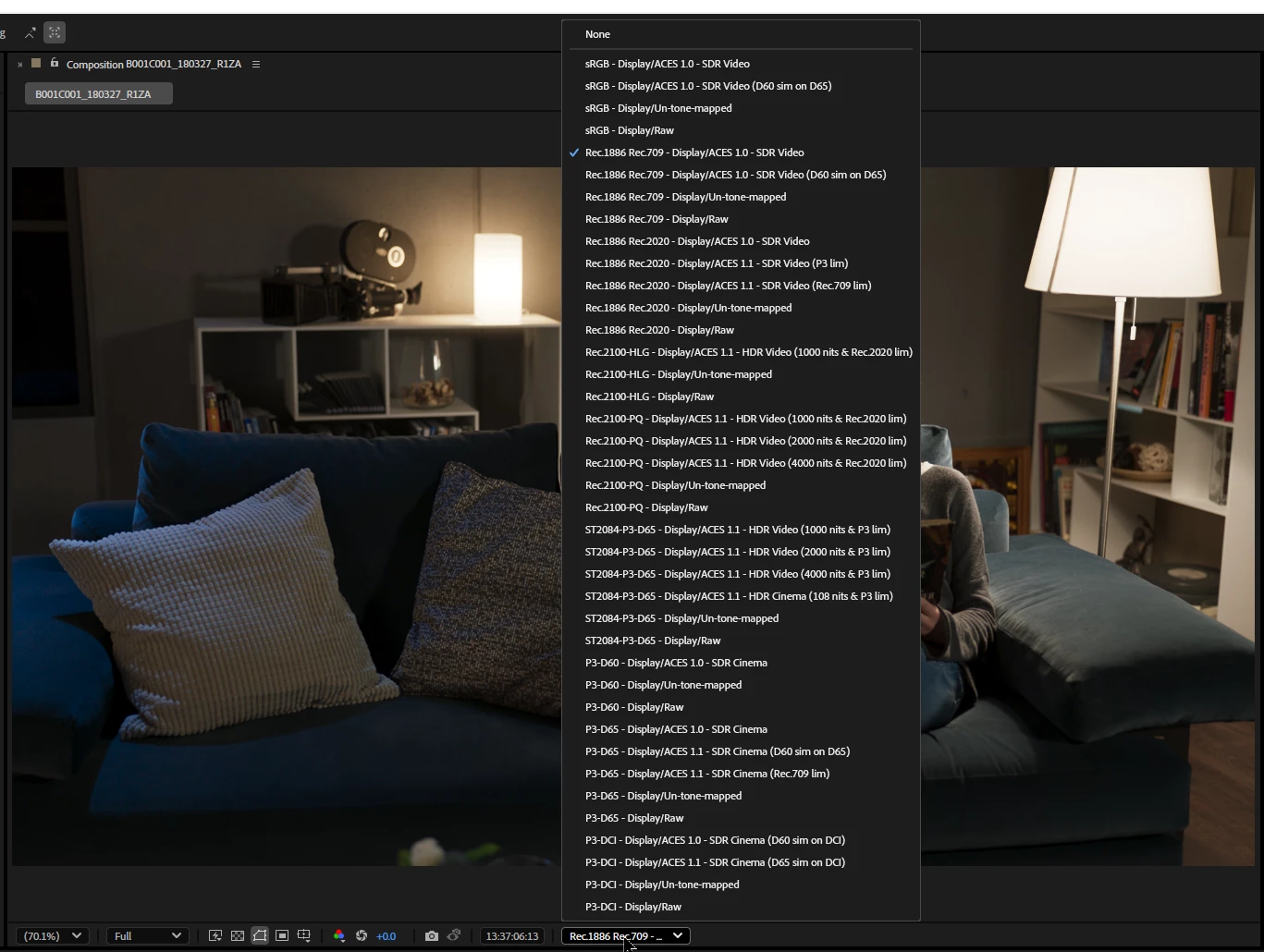

I'm happy with OCIO being implemented but there's still a lots of polish needed.
Viewers
One of which is to separate the view from the display for the viewer and output color settings.
It is much cleaner to work with over the flattened list we currently need to deal with.
Current:
Suggested:
The name labels could be shortened to View and Display if the viewer panel is too small and be removed if even smaller.

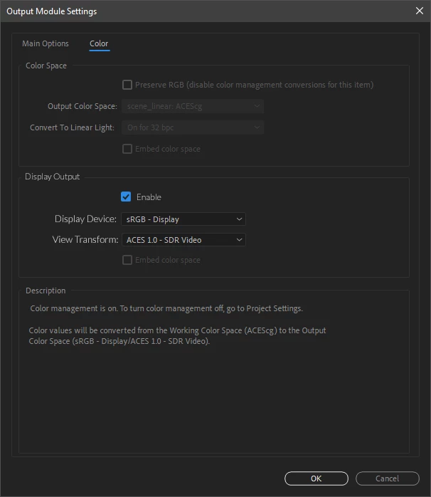

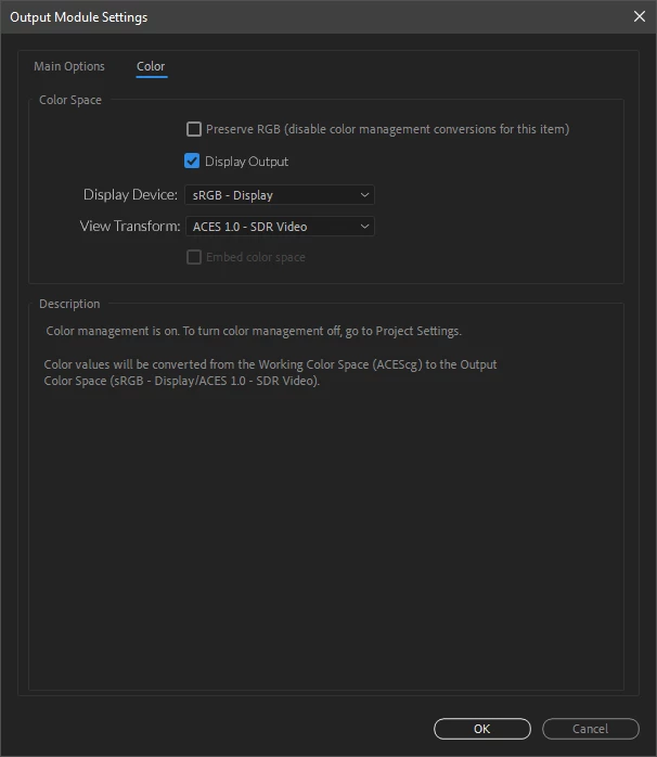

Output Module
For the Output Module I'd like to see a dedicated 'display bake option'. The current Show All checkbox lists the display+view spaces all the way at the bottom which is unwieldy and functionally doesn't make sense.
Here are two suggested approaches.
Option 1: Where the context of the menus change once the Display Output box is ticked.
Option 2: An additional section that becomes enabled when Enable is ticked and the above gets greyed out.
