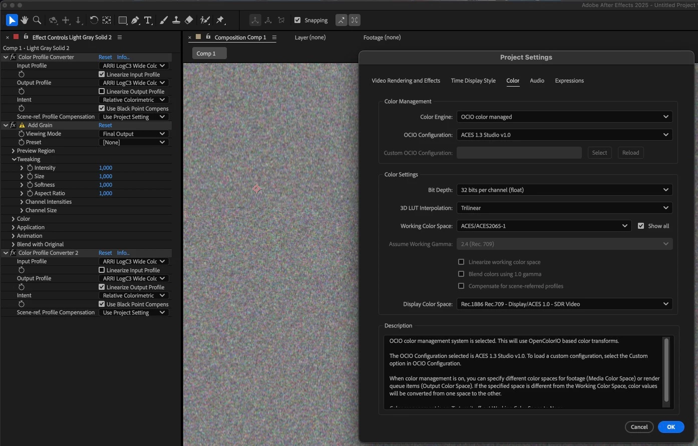

When using OCIO project management there is no need to use the color profile converter, it's rather counter intuitive to the toolset expected to be used in an OCIO based project. It would be better to use OCIO ColorSpaceTransform and convert from the working space ACEScg to ACEScct -> add grain -> convert back. There is also no need to set the working space in the project to ACES2065-1, in fact this should never be used as a working space. It is not how ACES is intended to work and neither is it a practical space to work in. It is and should only be used as 'ACES compliant' file interchange and archiving format.

OK. While we wait for the miracle to happen, I would like to share my Add Grain workaround for working with log material in the 32-bit. You'll need to use full ACES/ACES2065-1 colourspace to keep transformation transparent.
