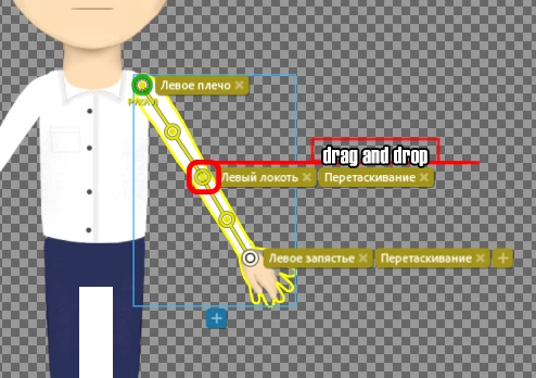

Fixed size (without stretching, but with the ability to drag) Hands - brachium, antebrachium(Forearm
I saw the option "OK hands", but still the character is stretched like an elastic band. I would like to give a parameter forbidding the bones to open: Hands - shoulder, front of the shoulder (forearm), foot - thigh, lower leg.
There were times when the elbow jumped when recording animations across the screen. (ate not put a point on the elbow)

@Иланна Марченко I'm not sure how to answer the question. Placing sticks (bones) in the arm along with tags for elbow and shoulder will allow you to apply a behavior called 'Arm IK'. Parameters there will allow you to adjust maximum stretch and adjust point at which elbow bends. A wrist tag with a draggable behavior will allow you to drag the arm. Does that help?

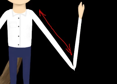

николайо62146779
févr. 7, 2023 9:35 AM UTC
no. Arm IK does not help.
hands stretch like rubber if pulled by the elbow. but if you pull by wrist, then everything is fine. but sometimes you need to move the elbow to establish the correct point in the position of the hands. and they begin to stretch as in the picture
