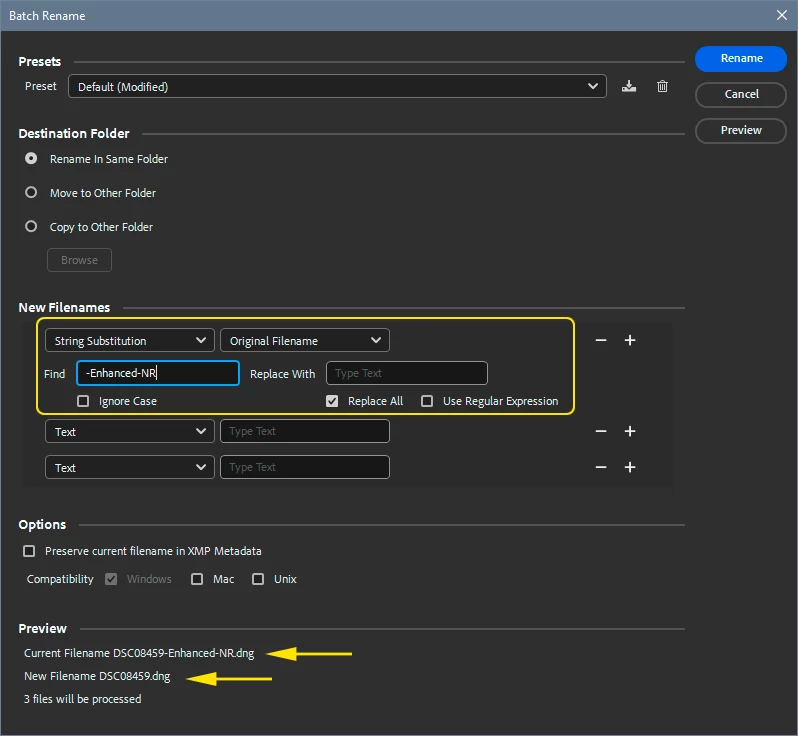

May 16, 2024 6:25 AM UTC
Naturally, you'd copy the files over to a folder ready to send. That's where you rename.
May 16, 2024 6:22 AM UTC
Bridge is not suitable for renaming enhanced files. If you rename imagefiles in other apllications then lightroom, your LrC-catalog won't find your imagefiles anymore...
The only way to rename them safely is in LrC, but you can do it only file by file.
May 15, 2024 8:24 PM UTC
Bridge is a step I never use. I haven't used bridge in decades. I'm not about to start doing it now. I'm hoping Adobe fixes this.

@danielb92063033
Actually, if you have Bridge installed, you can batch rename there. Set it like this, hit go and sit back:
