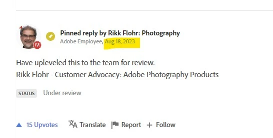

Mar 14, 2024 12:58 PM UTC
Hi Rikk, any updates??
Thanks
