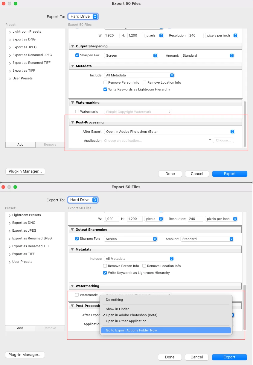

That method does work but after 20 images or so it just starts skipping files. Also, I make hundreds of actions and I don't like going to the export actions folder to clean up droplets every so often. It's so messy. The way bridge is set up is so much nicer and the actions run flawless. I am just hoping that this feature is updated in a future version of Lightroom.

We've been able to batch export into Photoshop since version 1. It's even possible to specify the Action you what to run. I suggest  you check it out. If it's not what you require we can move your post to 'the 'Ideas' forum

This video from Julieanne Kost (Adobe) explains the process. It's dated 2016, but the feature hasn't changed much, if at all, since it was first added to Lightroom.
