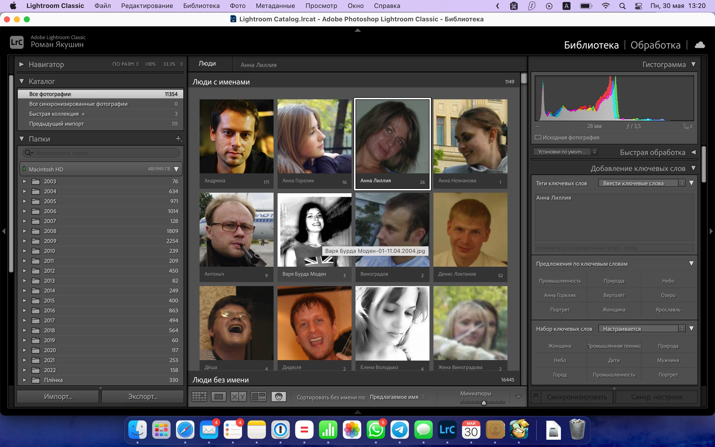

May 30, 2022 10:26 AM UTC
When you mark a person in a photo, Lightroom itself chooses (apparently at random) the photo to display on the "cover". Do you know if you can somehow select this photo yourself? Ligthroom always chooses the most nightmarish and atypical one ))
Select, displaying here, as in the attached screenshot.
GoldingD
May 30, 2022 3:40 PM UTC
Not a Face Rec user, but
So you are looking at a stack of images with the same name (face), Probably like any stack, you can expand the stack, select the image you want shown, and select that image as on top.
link below on stacking, not nessecarily correct foe Face stacking:
https://expertphotography.com/lightroom-stacking/
