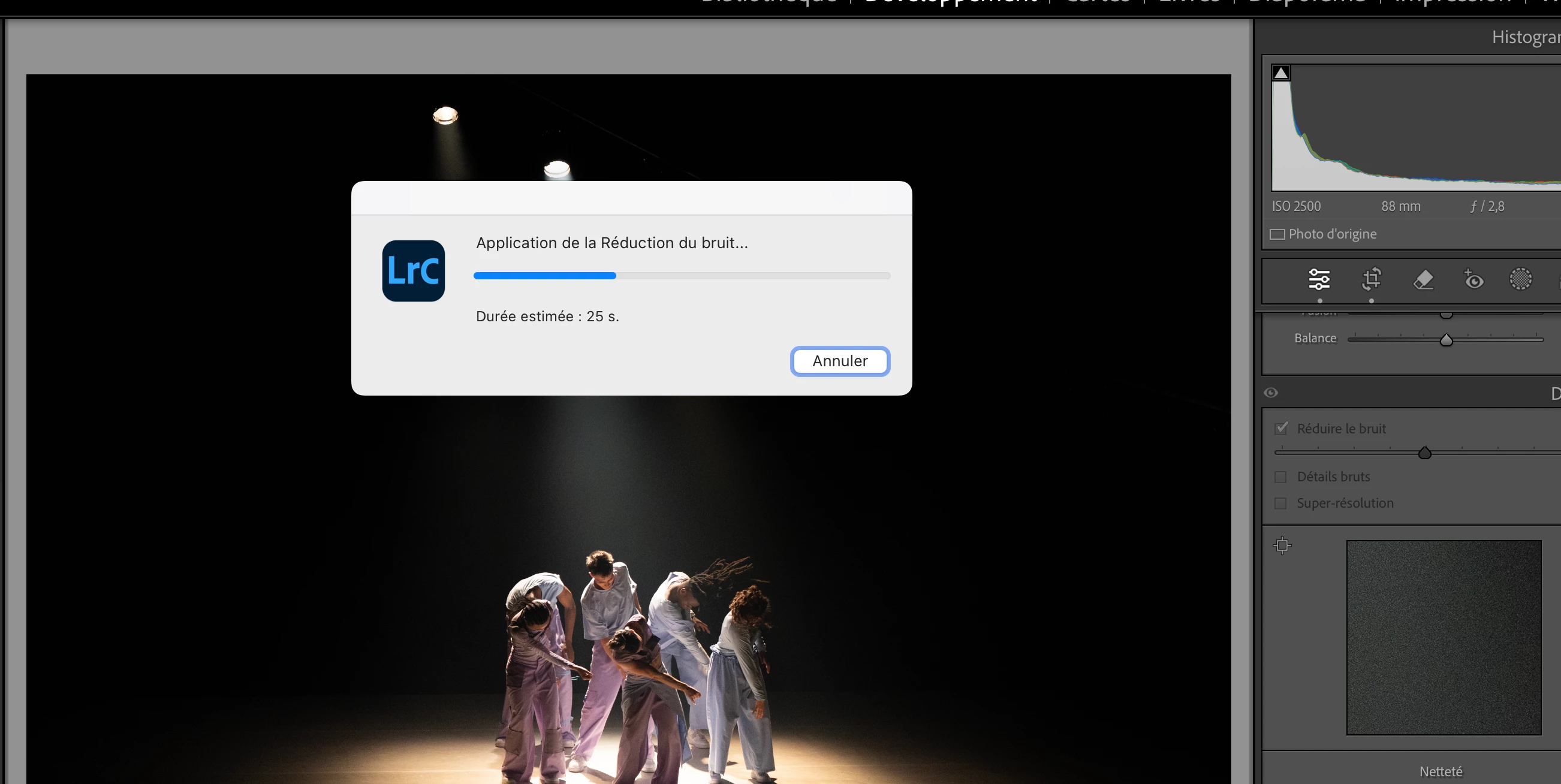

@Superpow: "I recently updated Lightroom (version 14.4) and I find myself using noise reduction again. Previously, I would edit my photos beforehand, and then apply noise reduction at the end, let it work, and during this time I could process another album in Lightroom in parallel. Today I have to do 1 by 1 and I can't do another action in parallel. I don't know if I'm clear? Does anyone have this problem? Could you give me some solutions?"
Unfortunately, the new design of Denoise prevents you from running it in background while you do other work in LR. As you can see in this thread, many users are quite unhappy about that.
However, you can apply Denoise to an entire batch of photos at once, rather than doing it one by one -- use Copy/Paste, Sync Settings or Auto Sync to copy the Denoise setting from the first photo to the other photos in the batch. Or you can define a preset, which you can apply to a batch of photos in Library by doing Quick Develop > Saved Preset.

Bonjour,
J'ai fait la mise a jour Lightroom dernierement (version 14.4) et je me retrouve avec une nouvelle utilisation de la reduction de bruit. Auparavant, je retouchais au préalable mes photos, et j'appliquais la réduction de bruit à la fin, je laissais travailler, et pendant ce temps je pouvais traiter un autre album sur lightroom en parallèle. Aujourd'hui je dois faire 1 par 1 et je ne peux pas faire une autre action en parallèle. Je ne sais pas si je suis claire ? Quelqu'un a ce souci ? Pourriez vous me donner des soultions ? Merci 🙂
