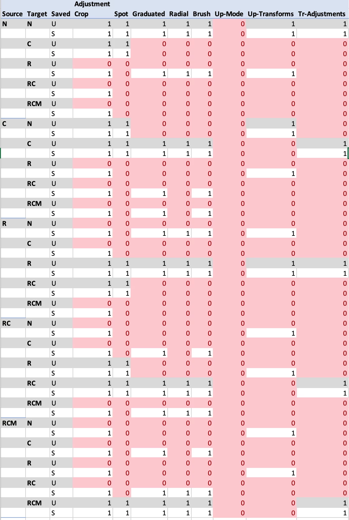

Lightroom has long incorrectly copied crops and local adjustments between photos with different orientations. This post provides consistent principles of how copying should behave, test results of the current broken behavior, and a guide to implementing correct behavior.
How Copying Crops and Adjustments Should Behave
Users almost always place crops and local adjustments relative to the photo's content. A Spot Removal is placed over a blemish on a face; an Adjustment Brush lightens the shadows under eyes; a crop is placed tightly around a face; a Graduated Filter darkens the sky.
So if a user copies a crop or local adjustment from a raw to a TIFF produced from that raw by Photoshop, the user expects the adjustment to appear in the exact same visual position and have the same effect. A Graduated Filter aligned with the horizon in the raw should also be aligned with the horizon in the TIFF; a Spot Removal applied to a face blemish in the raw should be located on that blemish in the TIFF.
Problems
When a user edits a portrait raw in Photoshop, the saved TIFF will appear portrait. But internally, the orientations of the two photos are different – the raw pixels are stored in landscape with an orientation tag indicating a 90-degree rotation, while the TIFF pixels are stored in portrait with an orientation tag indicating no rotation.
When a user copies a crop or local adjustment between photos with different orientations or crops, LR usually copies the crop or adjustment incorrectly, placing it in the wrong location and with the wrong size. The precise behavior of LR has varied across versions, but it's never come close to being completely correct.
I've done extensive testing of copying between orientations and crops, and the most recent results for LR 11.0 are posted below:
https://community.adobe.com/t5/lightroom-classic-ideas/lightroom-correct-copying-of-crops-and-local-adjustments-of-virtual-copies/idc-p/12489948#M13017
There hasn't been much change from LR 10.3, though LR 11 did fix one important use-case, copying adjustments between masters and their virtual copies.
Implementing the Desired Behavior
Implementing the desired behavior is straightforward, requiring elementary coordinate transformations from the source to destination photos. I've implemented these transformations for my Copy Settings, Any Crop, and Any Filter plugins, and I've posted the source code for Copy Settings plugin.
Internally, LR represents a photo as an underlying image (an array of pixels) and an "orientation" tag, which specifies how much the underlying image should be rotated (0, 90, 180, 270 degrees) and whether it should be mirrored to display it visually. Rotating or flipping an image in LR changes just the orientation tag. But when you edit a photo in Photoshop, it actually rotates and mirrors the pixels in the underlying image as specified by the orientation, and the saved TIFF will then have an orientation tag with no rotation or mirroring.
LR represents the coordinates of crops and local adjustments with values in [0..1], where (0, 0) represents the upper-left corner of the underlying image before any orientation (rotation and mirroring) has been applied. Call this coordinate system the underlying-pixels coordinates. Call the coordinate system after the orientation has been applied the visible-pixels coordinates.
When copying, LR should translate the underlying-pixel coordinates of the adjustments in the source image to visible coordinates. Then it should translate those visible coordinates to the underlying pixel coordinates of the target photo.

johnrellis
July 5, 2026
I reran my test suite on LR 15.4.1, and unfortunately, I don't see any improvements since the last time I tested with LR 11. :-<
The suite can be downloaded from here:
https://www.dropbox.com/scl/fi/6yaidx18dppg7s4k0phhp/Copy-Settings-test-suite.2026-07-04.zip?rlkey=229gifzs8rvj40taoofaunluj&dl=0
In the tables below, the Source and Target representations are:
N - the photo is in normal orientation, with no rotation or mirroring (orientation AB)
C - same as N but with a crop applied, including a crop angle
R - the photo has been rotated clockwise (orientation BC)
RC - the photo has been rotated clockwise, with the same crop as C applied
RCM - the photo has been rotated clockwise and mirrored (flipped horizontal), with the same crop as C applied (orientation CB)
U - the tested adjustment has not been saved to metadata in the source photo
S - the tested adjustment has been saved to metadata in the source photo
The adjustments tested are:
Crop - a crop with a crop angle
Spot - a spot removal using Clone, with the source automatically selected
Graduated - a graduated filter (linear gradient), at angle (now called Linear Gradient in LR 15)
Radial - a radial filter (radial gradient), at angle (now called Radial Gradient in LR 15)
Brush - a brush mask
Up-Mode - Transform > Auto, copying Upright Mode
Up-Transforms - Transform > Auto, copying Upright Transforms
Tr-Adjustments - copying manual Transform adjustments (now called Manual Transform [sic] in LR 15)
Note that the suite does not (yet) test brush masks with very large numbers of strokes (dabs); the representation for these has changed in LR 15.4.
The first table shows the results of the suite with LR 15.4.1. Red cells indicate source/target/adjustments that didn't copy correctly.

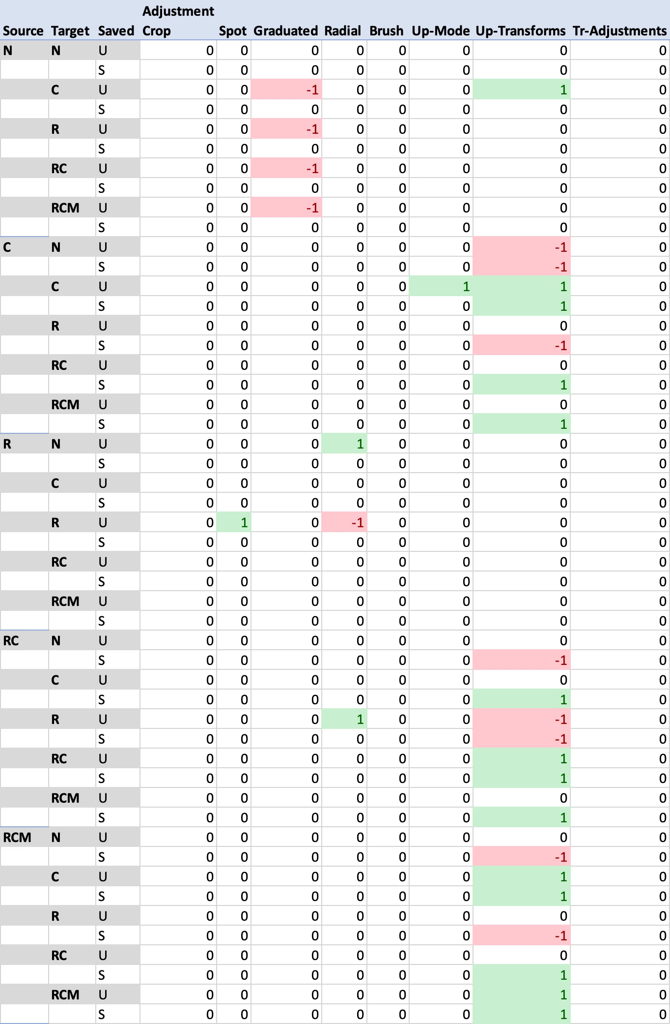

The second table shows the difference between LR 15.4.1 and LR 11.1. Red cells indicate source/target/adjustments that don't work in LR 15.4.1 but worked in 11.1. Green cells indicate source/target/adjustments that work in LR 15.4.1 but didn't work in 11.1. There are 13 red cells and 18 green cells -- so little net change.

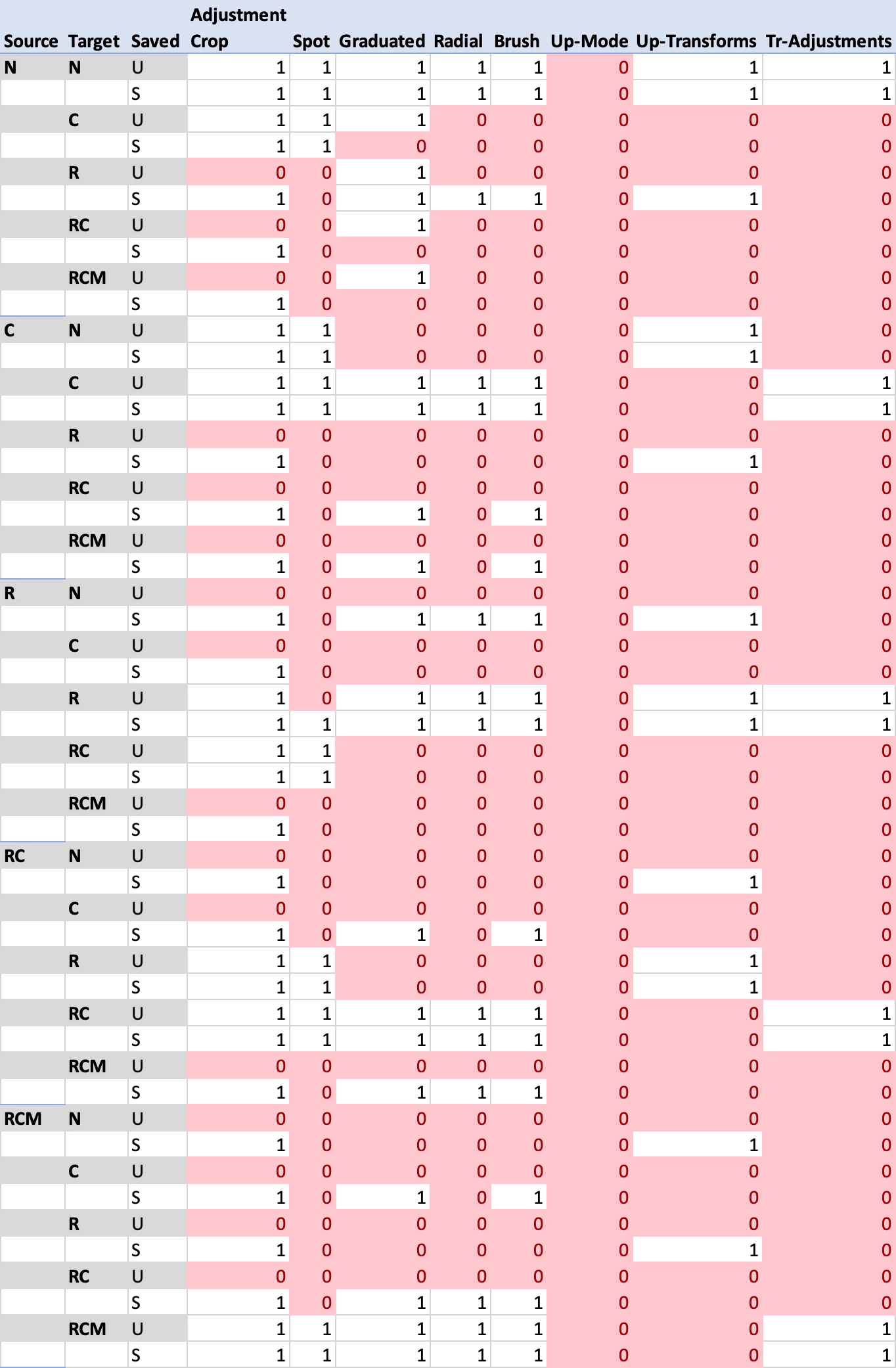

December 18, 2021
I reran my test suite on LR 11.1, and unfortunately, I don't see any improvements :-<
https://www.dropbox.com/s/ayr602oegx3ofrr/Copy%20Settings%20test%20suite.2021.10.31.zip?dl=0
Graduated - a graduated filter (linear gradient), at angle (now called Linear Gradient in LR 11)
Radial - a radial filter (radial gradient), at angle (now called Radial Gradient in LR 11)
Tr-Adjustments - copying manual Transform adjustments (now called Manual Transform [sic] in LR 11)
The first table shows the results of the suite with LR 11.1. Red cells indicate source/target/adjustments that didn't copy correctly.
The second table shows the difference between LR 11.1 and 11.0. Red cells indicate source/target/adjustments that don't work in LR 11.1 but worked in 11.0. Green cells indicate source/target/adjustments that work in LR 11.1 but didn't work in 11.0. There are 5 red cells and 1 green cell -- so very little change.
