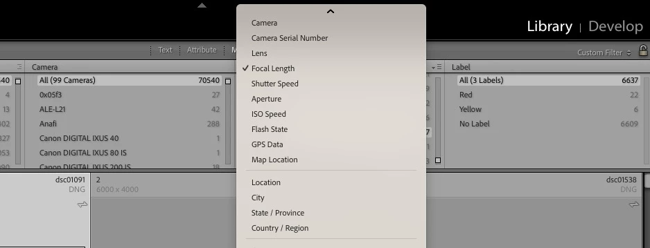

But here comes another problem: even when this "Focal Length 35mm" field is populated, it is not available everywhere - unless I am missing something, I can't display this 35mm equivalent:
• As part of the info in Loupe Overlay
• As part of the info in Grid Extras overlay
• As a Metadata column filter (there's a plugin by Jeffrey Friedl that fixes this specific issue)
• Under the histogram (only "real" focal length is shown)
• In the Map module, in the small thumbnail pop up that appears when clicking the photo's orange pin in the map (only "real" focal length is shown)

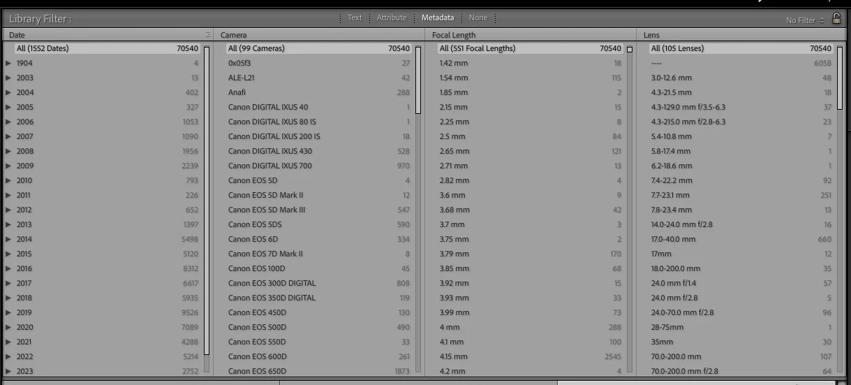

  3. Many photographers use various cameras, ranging from phones, drones, ... up to full frame or even bigger. Having the ability to filter through all of these would be great. Not to mention (much) older cameras which used to have smaller sensors. I'm not an expericed photohrapher nor am I a pro. And yet, my library contains a zoo of cameras and lenses:
  4. Comparing field of fiew is usually more important or makes more sense than real focal length. Especially when shopping for a lens.
  5. Could even make sense on full frame bodies when the crop mode is enabled. Images from the same body+lens combo would then be discernated, whereas they're not when you filter based on the focal length only.
  6. Since the data is already available, adding this to the filter feature should be pretty easy

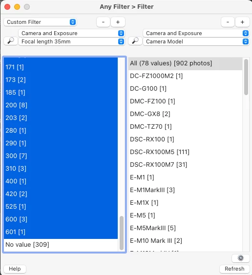

To build on previous discussion, not all cameras record the EXIF field Focal Length 35mm. My test catalog includes sample photos from 111 distinct camera models, and only 78 of them recorded the EXIF field Focal Length 35mm:
(It may be that some of those other 33 camera models may record Focal Length 35mm with other lenses than used in the catalog's sample photos -- I haven't investigated.)

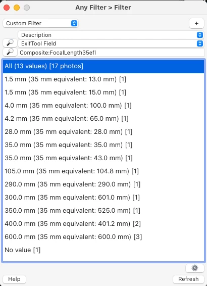

It's a straightforward calculation to use other EXIF fields usually included by cameras to compute the effective 35mm focal length.  The Exiftool utility will do that calculation for you,  and its tag Composite:FocalLength35efl displays EXIF:FocalLength35mm if it was recorded by the camera, otherwise it will display the calculated value.  However, if the pixels in the photo have been cropped or resized, the calculated value will be wrong. (LR cropping won't affect the calculation, since it doesn't affect the pixels in the master photo.)
You can use the Any Filter plugin's Filter command to see the computed FocalLength35efl:
Unfortunately, it sorts the column by the actual focal length, not the effective 35mm focal length, due to the way Exiftool displays those values.
