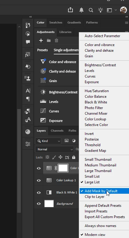

​@boonheilig you can already do that for the adjustment layers from the panel fly-out menu

Awesome, thanks ​@Ged_Traynor.
Is there a solution for smart filters aswell, or does that same option do it for both?
boonheilig
Jun 17, 2026 9:10 AM UTC
Oh, wait.. that’s from the adjustments window, but when making adjustment layers from the layers menu (bottom buttons in layers window) it disregards the setting in the adjustments dialog. Also when making adjustment layers with actions it keeps making masks.
