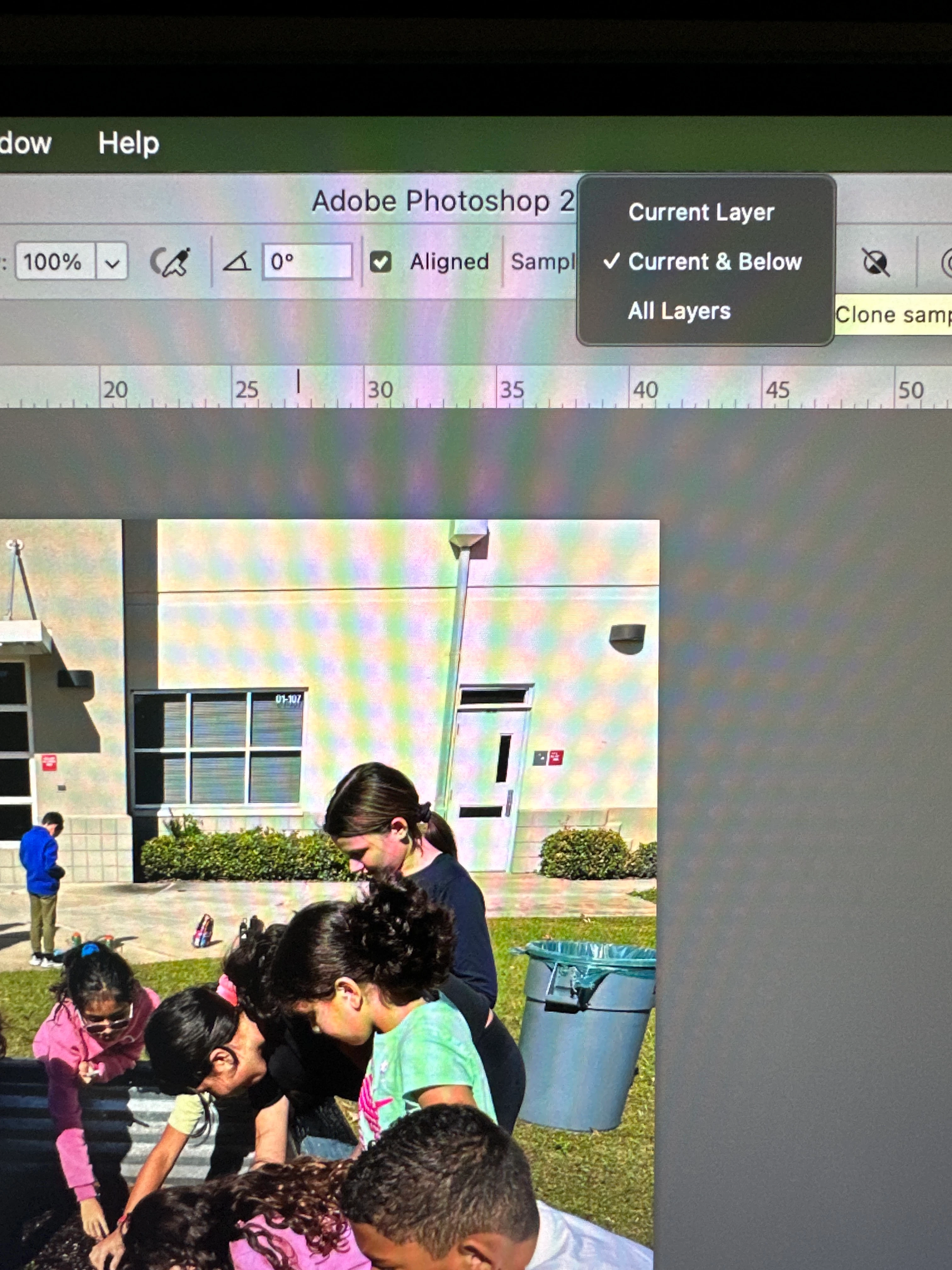

Jumpenjax
February 20, 2024
On the clone tool, along top screen there is a sample current layer, current and below, also all layers.
Lee- Graphic Designer, Print Specialist, Photographer
