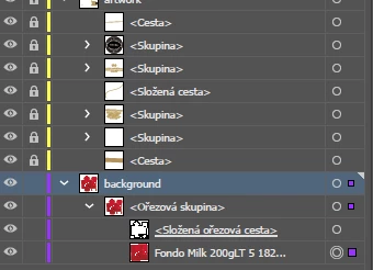

At the end Ilustrator works (merging transparency works like screenshot if you uncheck preserve pantone colors)... but it still has few issues but they are way less visible than false colors in photoshop. (in ilustrator... you should merge as less staf as possible becouse at the end around sharp edges it could make some artefacts... so in the best case merge only pantone layers and other texts or png add on top of it... for my case we are geting printing artworks in ilustrator... so i just take background pantone layers which are link from photoshop. So i do not need to do almost anything)
so 1. step check only layers which has some pantone inside... (not gold or silver ones theese pantone colors need to be faked by hand or replace in 3D by gold material)

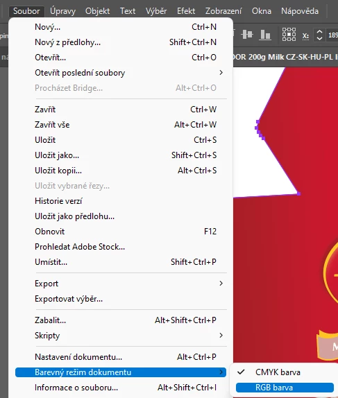

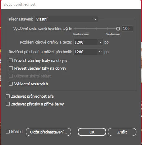

2. step set document color mode as RGB if you wont RGB.. if you wint final image in CMYK than set cmyk (if you not sure always chose RGB - it has better color range)

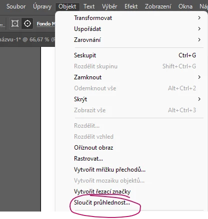

3. step go to Object/Flatten Transparency...
4. step in new window uncheck all checkmarks... and both ppi text box set to your ppi which you will be exporting (i amd exporting in 1200)... and slider set to 100
5. step press OK (your layer will be merged... if you checked more layers they mabie jumped higher in your layers... so make sure you are not hiding anything below...)

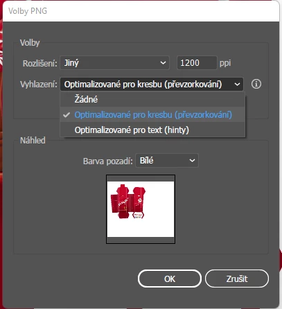

6. step export as PNG set ppi you set in step abowe and make sure you checked Art Optimalized (Supersampling) if you would not do Supersampling than there will be Hairpin micro-Strip lines from the flattening.
And now you have wisibli way better merged pantone colors than from photoshop.

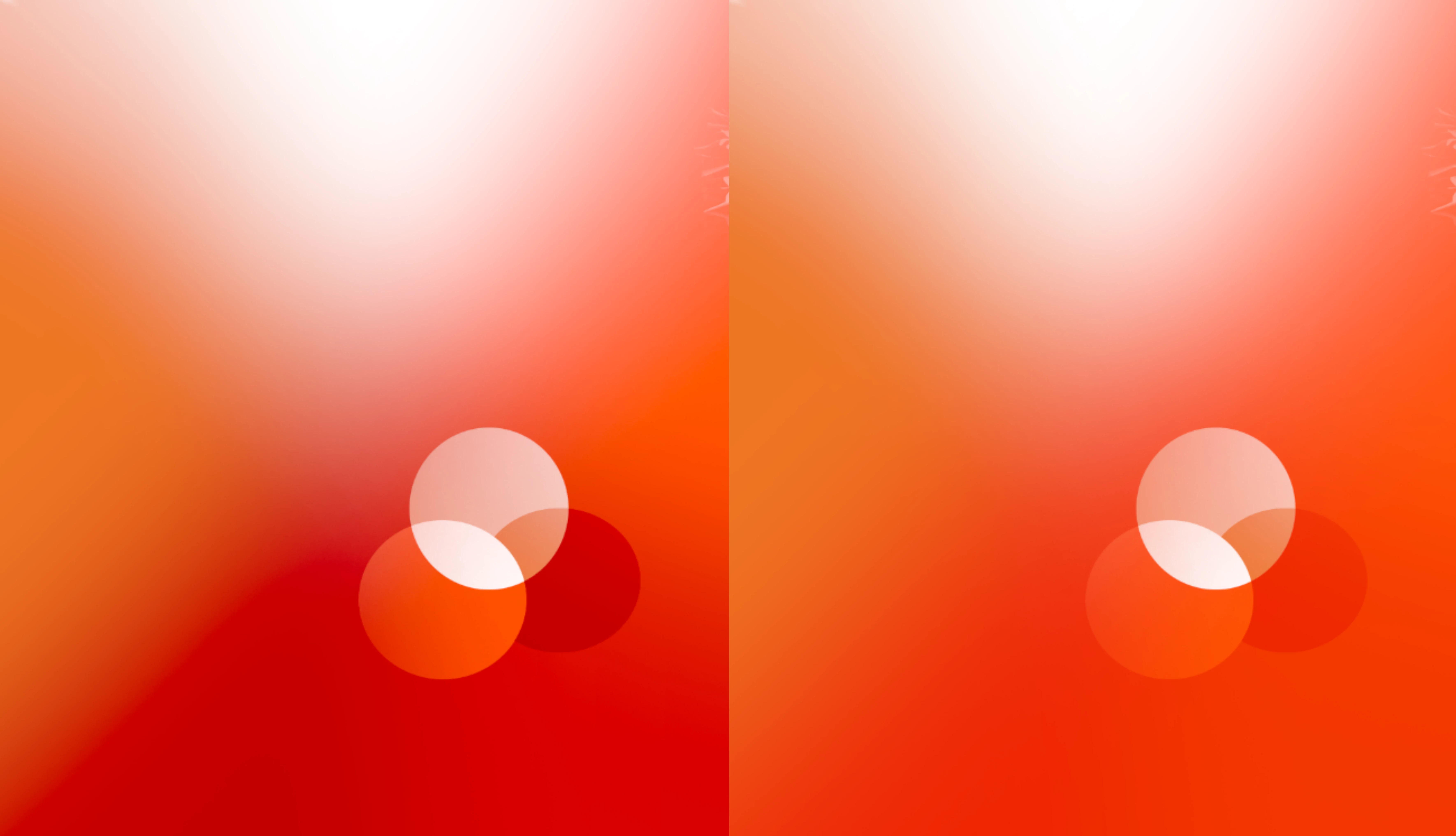

Here is the resolut
1. is photoshop merging pantone
2. is original screenshot from photoshop
3. is flattening with pantones in ilustrator
you could see still tyni diference... but it could be just becouse of preview settings of ilustrator... can not tell which one ( pre merging or after flattening in ilustrator (2. or 3. picture) looks more simular to real print product... hard to tell diferent lightning in real life diferent color, reflections... ... ...) but the resoluts are absolutly fine now...

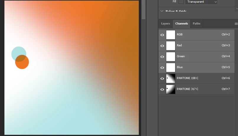

combining 158C, and 317C in prophotoRGB does noto make any visible diference
D Fosse
May 23, 2022
OK, I assumed that orange could be held in ARGB, but apparently not.
In order to troubleshoot this, it is absolutely essential to remove out of gamut from the equation. If this is not a bug, out of gamut is the only explanation - except if it was a noisy image. Is it? Then you need to compare at 100% (insert long and separate explanation here). I didn't get the impression that there were any noise effects here.
So we have two Pantones that are definitely in gamut: 158C, and 317C. How do those two behave?
But all in all, from what I get from the above posts, it does sound like a bug.

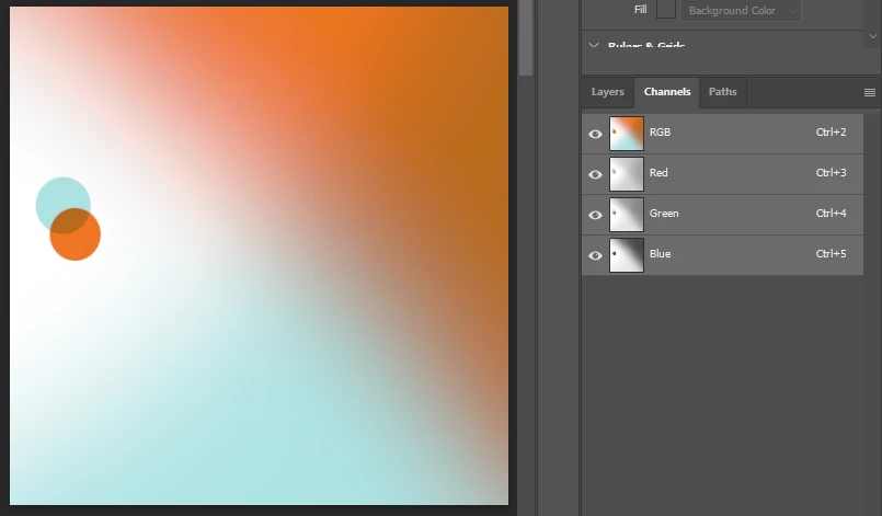

May 23, 2022

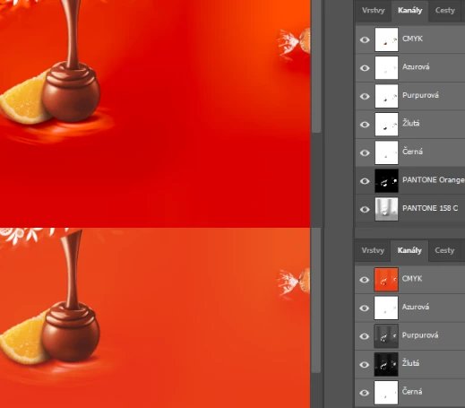

AdobeRGB does not make visible diference from my perspective... both of theese screenshots are from adobeRGB before and after spot colors merge (left one before - right one after)
here are the AdobeRGB project files if you would like to see with your own eyes (as you can see screenshot can capture the diference so i think my idea of photoshop full quality something like screencapture export would be working better than merging chanels like this) and it could also help people which would like to export measurements or image borders...

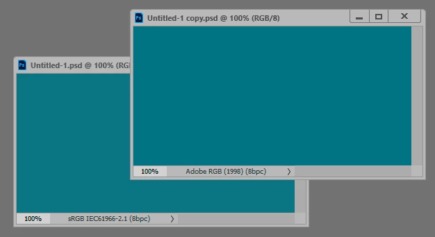

Pantone 7474C, as defined by Lab 43 -35 -18, is outside sRGB gamut. It can be reproduced in Adobe RGB.
This screenshot has Adobe RGB embedded and shows the difference, if seen on a wide gamut monitor (the inline image has the profile stripped, so click to show it correctly):
