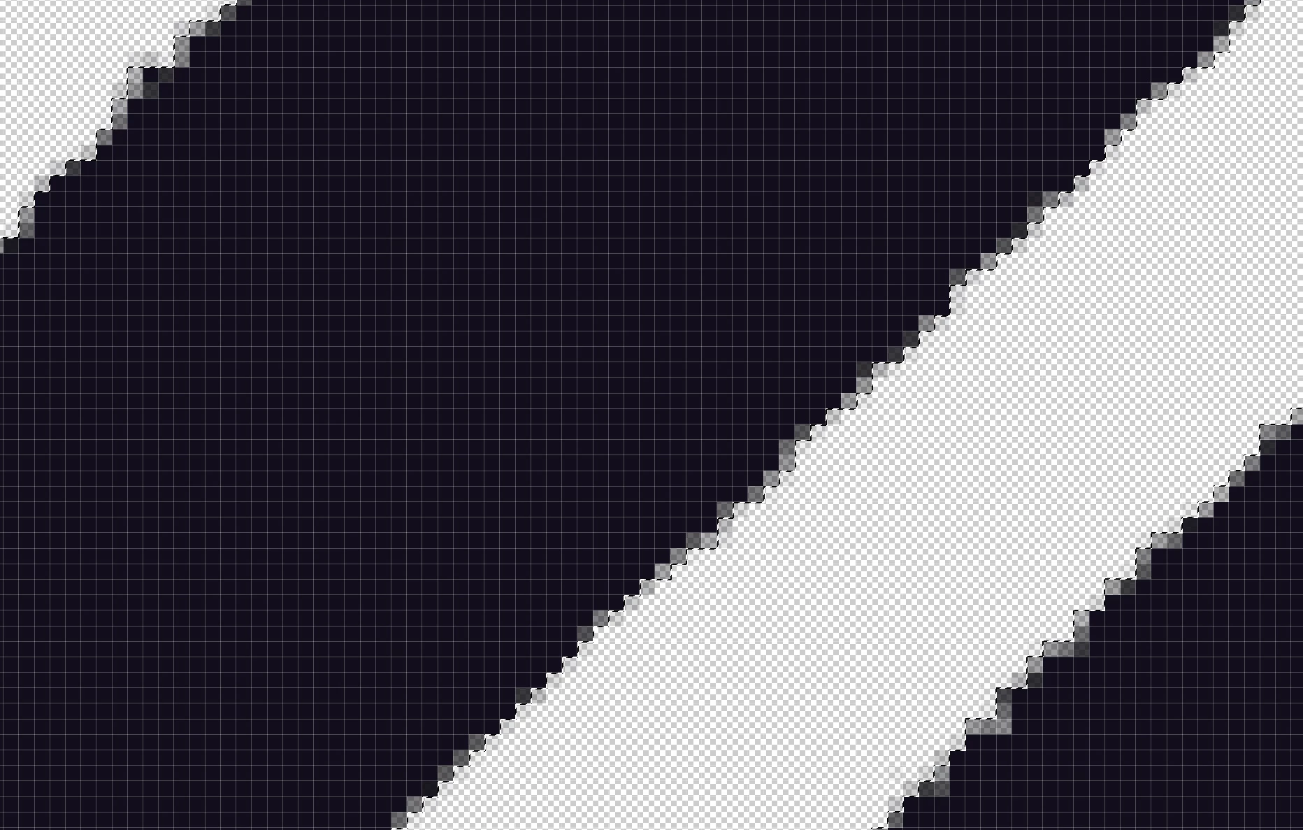

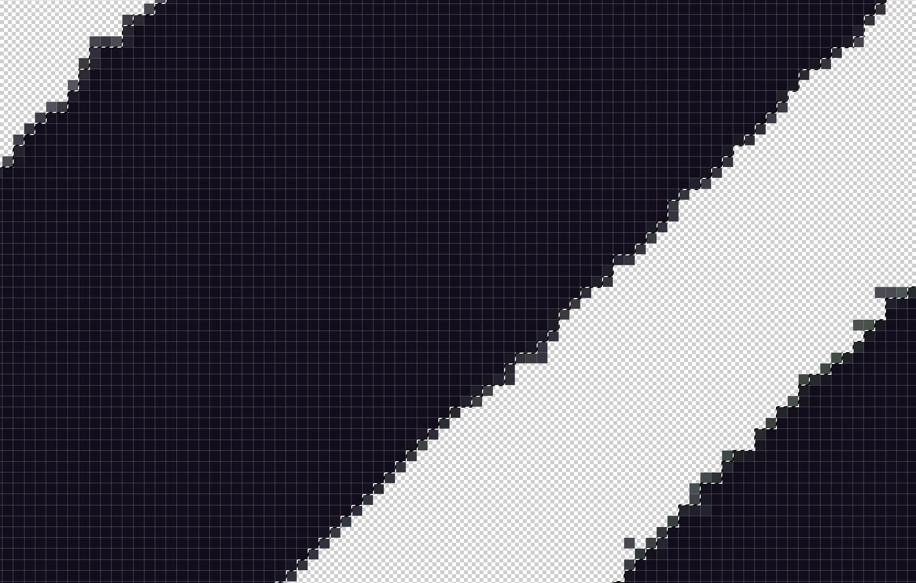

If you hit Delete when making a selection area can the pixels in or out of it be deleted only please
I don't know why but it's deleting pixels inside the selected area I made by left clicking while holding ctrl in and clicking on the layers image icon to make the selection
and when I go to paint them back in it goes outside the selection area..
My usual fix for it is first making a copy of the layer
then hiding the original
hitting ctrl J heaps of times to make copies then ctrl E to compile them
(there had to be an easier way to get pixels back like this cause it wastes so much time)
making a selection from the original image whilst on the copiled copy layer
hitting inverse and then hitting delete, same problem.
is there a setting i'm missing to specifically delete inside or outside the selection area if I selected inverse or not?

Selections are anti-aliased i.e. the edges of diagonals are feathered so as not to introduce visible stepping.
You could instead add a mask and draw on it with the pencil tool which is not anti-aliased. Copying the layer and inverting the mask gives an exact invert.

Hmm, I seem to have made a work around it.
You hit ctrl J heaps of times to make copies then ctrl E them all execpt the last one
you then use that last one as a reference to delete pixels off the copies.
when you deleted all the pixels you delete the original
takes a while but I guess it's what happens if theres faded pixels. \__(o,o)__/
