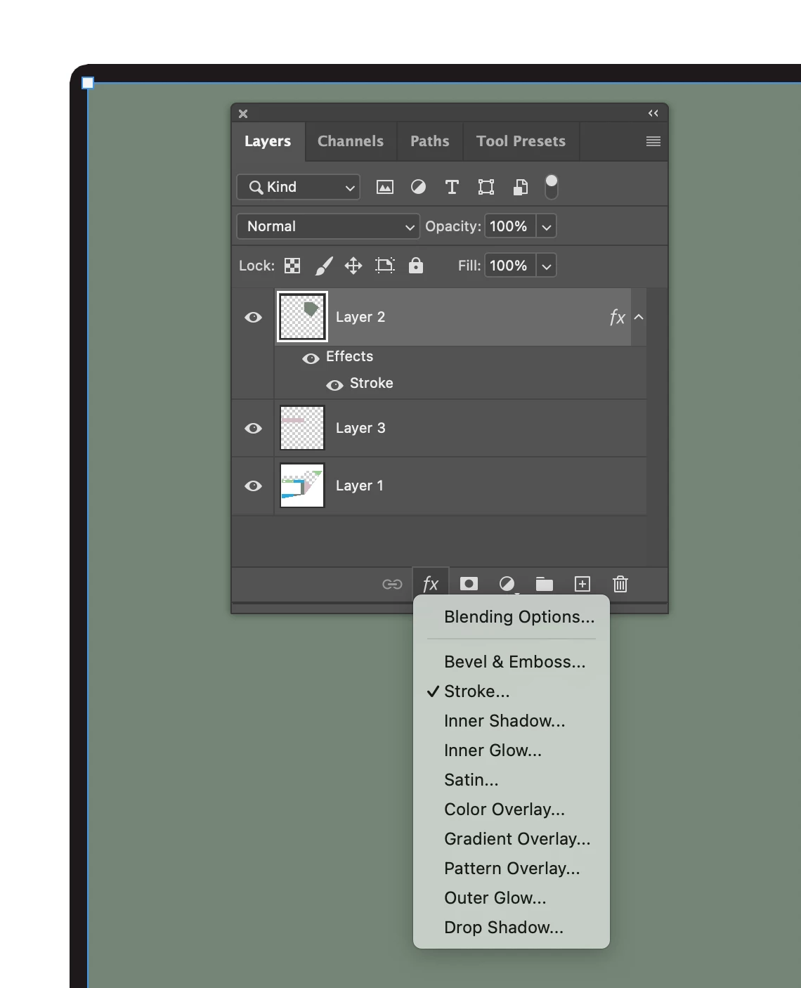

Outside stroke with square corners
I would like to be able to apply an outside stroke with square corners to any layer in Photoshop. The layer styles stroke tool always rounds the corners when setting the stroke to outside. I don't want the stroke inside because it covers up part of the layer. I know this can be done in the vector shape stroke tool, but I would like this same functionality to be available in the layer styles stroke tool panel. Or better yet, one tool to apply any kind of stroke to any layer would be great. I'd be happy with the same functionality in the existing tools, though. Thanks!

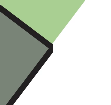

Mar 12, 2024 9:43 AM UTC
You may have to play with the action a bit...
Your off-list sample file had a stroke of 39 px.
I had to set a Maximum filter of 28 px. When I used 39 px the result was too thick, which was unexpected, so YMMV.
Then I made the stroke 56 px. It doesn't have to be double, just large enough that the rounded corners extend past the mask.
As you have rotated/angled content, I don't think that this will work for you as the corner is chamfered, not sharp:

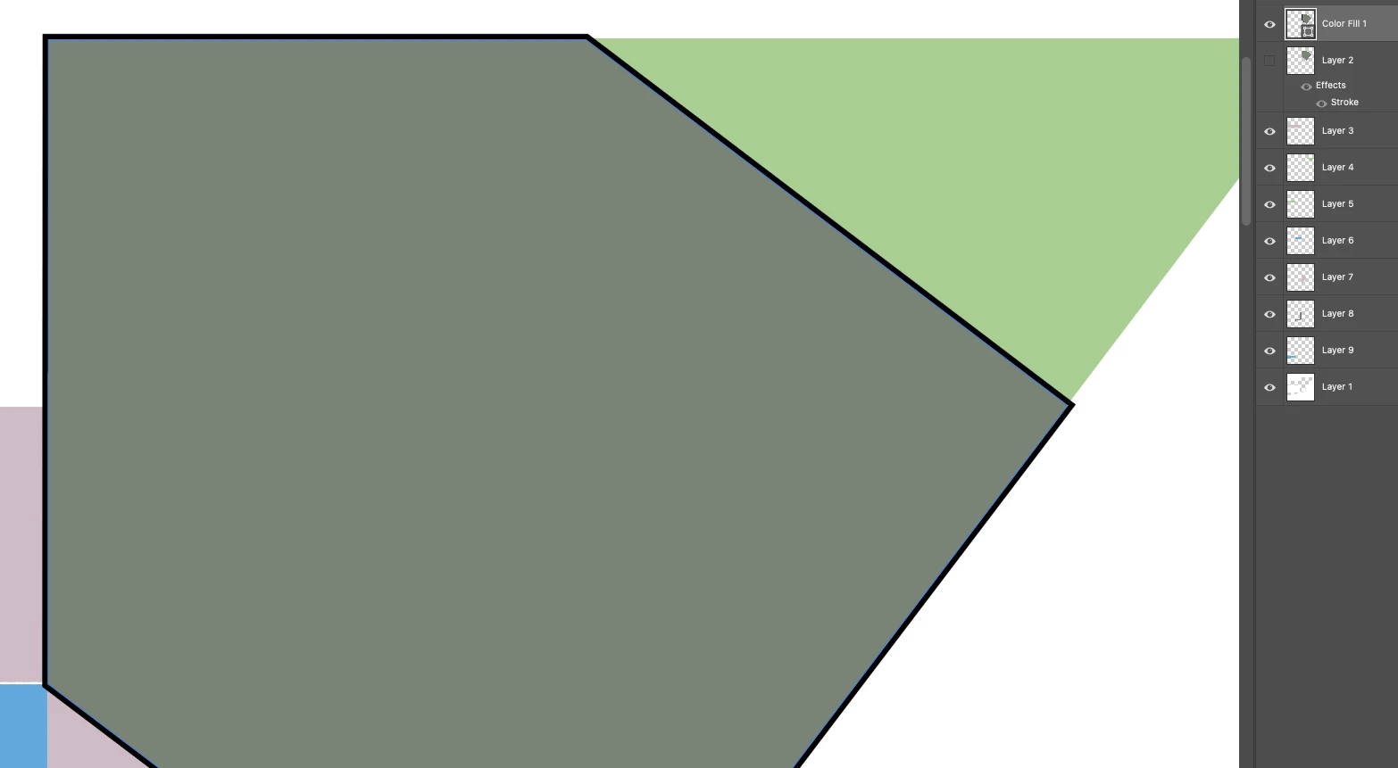

Mar 11, 2024 1:21 PM UTC
@Kaj35945084nura
Can you provide a sample PSD file?
As I previously wrote, vector shape layers avoid the problem. Otherwise, a workaround using a layer mask or clipping group layer with an oversized stroke is also possible.
Mar 12, 2024 7:26 AM UTC
Hi, the problem is that I have jobs like this. I need to get sharp angled lines around the pieces. There may be more than 30-40 pieces in the structure.
Ystävällisin terveisin,
Best regards,
Kaj Salin

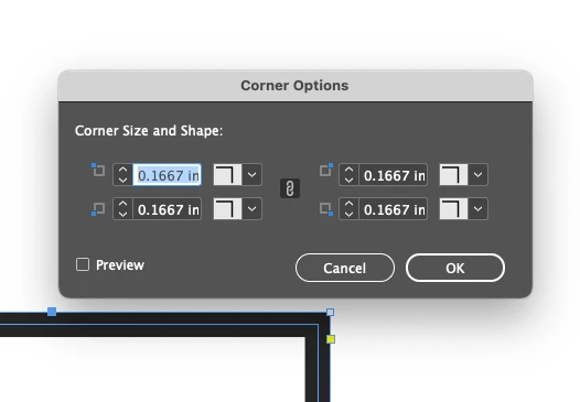

Kevin Stohlmeyer
Jun 22, 2023 3:39 PM UTC
@familybees perhaps what would be helpful is to allow the same stroke controls as InDesign or Illustrator which have join, corner and bevel controls:
