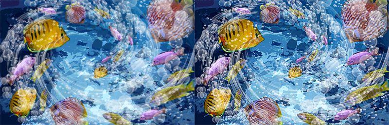

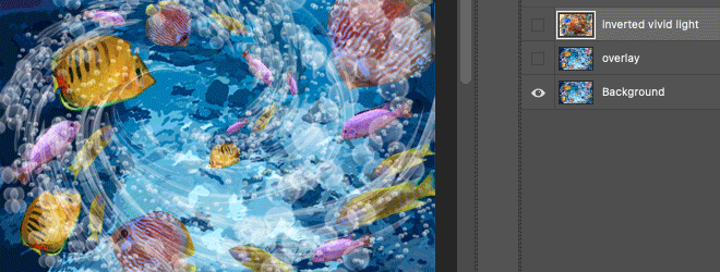

Steps to sharpen using layers, blend modes and blur:
  1. Duplicate the original flattened Background layer
  2. Let's call this layer "overlay" for clarity (named Faux USM 1 in my original screenshot)
  3. Set this layer blend mode to overlay
  4. Duplicate this overlay layer and rename it "inverted vivid light" for clarity (named Faux USM 2 in my original screenshot)
  5. Set this layer blend mode from overlay to vivid light
  6. Use the invert command on this layer
  7. Run Gaussian Blur filter or any other blur/smoothing filter on this layer to sharpen

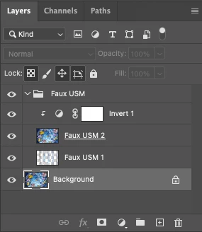

. Looks great, but I can't quite figure out how you did it. You say there are two layers in the group, but I see three, and I don't know how you made invert into an adjustment layer. I'm so confused! Can you please clarify the steps for us iPad total beginners? Thank you so mucn!
August 22, 2023
I get around this with 2 layers in a group 1) Base image 2)(above) Gaussian blur, invert, and change blend to vivid light. Change blend mode of group (with 1&2) to overlay. Acts like high pass filter ~
