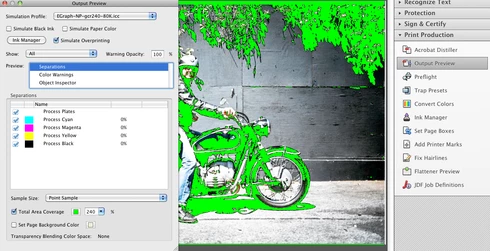

This is a request from those that do CMYK prepress work in Photoshop.
We are often having to convert images to CMYK profiles with custom ink densities to match certain publication standards.
There are profiled ink densities of all four inks that equal
240
280
340
etc...
The only way to check out the work we do in Photoshop is to generate a PDF of our file, Open it in Acrobat,
Go to Tools,
Output Preview
and check the Total Area Coverage warning.
It is Way too many extra steps for something that needs to get possibly re-adjusted in Photoshop.
It would be amazing to have this sort of preview within Photoshop. It would enhance productivity and file quality.
Unfortunately, I don't think there are too many pre-press operators that visit this forum but i can say that the prepress community is massive and would benefit greatly from this.
See the attached image of what I have to do in Acrobat.

Cristoph has a good solution. But it sure would be nice to have this feature within the actual application as a soft-proof-gamut warning type of option.

Thanks Cristoph but I am getting syntax errors. Could you email me the script or the adj layers? jjwithers at g mail dot com
c.pfaffenbichler
Oct 17, 2013 6:39 AM UTC
The lower Adjustment Layer is a Channel Mixer that »empties« Cyan, Yellow and Black and makes Magenta a mixture of 25% of each of the four Channels and has a Blend if »This Layer« setting corresponding to the intended TAC.
The Curves Layer adjusts the Layer additionally ...
But basically I use below Script to generate it, feel free to give it a try and let me know if you notice problems.

jjwithers
jjwithersAuthor
Oct 16, 2013 4:17 PM UTC
Humm.
Looks like a nice work around.
What is that ink density layer with the curve clipped to it?
Would you mind sharing it?
Thank you for your reply.
-josh
c.pfaffenbichler
Oct 16, 2013 6:26 AM UTC
One can automate a way of indicating areas above of a certain TAC in CMYK images, but there is a certain imprecission that gets worse if Spot Channels are involved.
Unfortunately the result, while it will reflect changes performed on the underlying image, would print if one does not hide/delete it before final saving.
Edit: If no Spot Channels are involved two Adjustment Layers suffice, but as the four Channels are bunched up into one the result is not perfect.
Also changes in the Spot Channels are not reflected.
