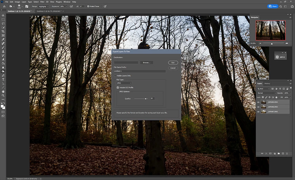

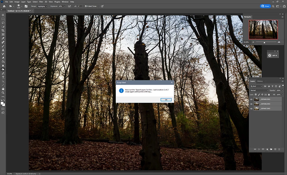

Many thanks for your continued effots on this - it's much appreciated. However, sadly, I'm still getting the same result. Running script 1 works perfectly, and a windows file dialog promopts me to set the save path, and the confirmation widown then tells me to run Script 2. On running that though, I simply get the regular save dialog but with no path saved in the field - still defaulting to the User folder 😞
I've attached screenshots of the two sequences, but I have no idea why the second one isn't picking up the saved path, as that is definitely updating in the log file if I choose a new folder to save to.
Cheers

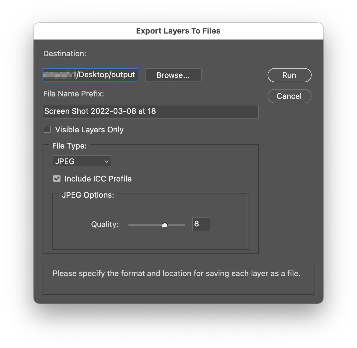

In this screenshot, the original file is on the desktop. When I held down shift, I selected a folder titled output on the desktop. When the script was run without shift, it defaulted to the output folder and not the desktop. Are you on Mac or Windows?
