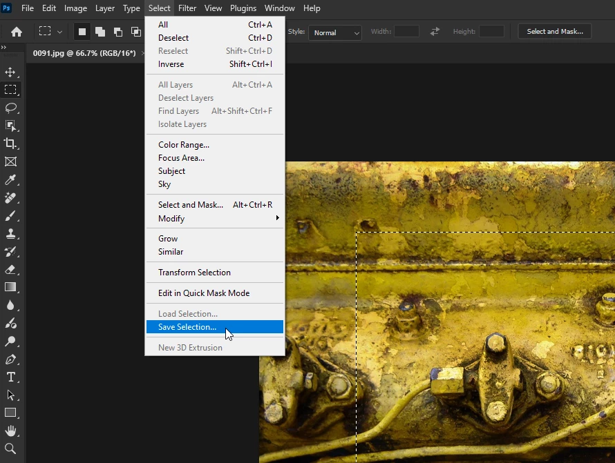

@JMLBloodLite not sure is this helps in your situation, but there is a save selection option in Photoshop
