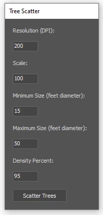

    var dlg = new Window("dialog", "Tree Scatter");
    dlg.orientation = "column";
    dlg.alignChildren = "left";
    dlg.add("statictext", undefined, "Resolution (DPI):");
    var resolutionInput = dlg.add("edittext", undefined, "200");
    resolutionInput.characters = 5;
    dlg.add("statictext", undefined, "Scale:");
    var scaleInput = dlg.add("edittext", undefined, "100");
    scaleInput.characters = 5;
    dlg.add("statictext", undefined, "Minimum Size (feet diameter):");
    var minSizeInput = dlg.add("edittext", undefined, "15");
    minSizeInput.characters = 5;
    dlg.add("statictext", undefined, "Maximum Size (feet diameter):");
    var maxSizeInput = dlg.add("edittext", undefined, "50");
    maxSizeInput.characters = 5;
    dlg.add("statictext", undefined, "Density Percent:");
    var densityInput = dlg.add("edittext", undefined, "95");
    densityInput.characters = 5;
    var scatterButton = dlg.add("button", undefined, "Scatter Trees");
    scatterButton.onClick = function() {
        var resolution = parseFloat(resolutionInput.text);
        var scale = parseFloat(scaleInput.text);
        var minSizeFeet = parseFloat(minSizeInput.text);
        var maxSizeFeet = parseFloat(maxSizeInput.text);
        var treeDensity = parseFloat(densityInput.text);
        if (isNaN(resolution) || isNaN(scale) || isNaN(minSizeFeet) || isNaN(maxSizeFeet) || isNaN(treeDensity)) {
            alert("Please enter valid numerical values for all fields.");
            return;
        if (resolution <= 0 || scale <= 0 || minSizeFeet <= 0 || maxSizeFeet <= 0 || treeDensity <= 0 || treeDensity > 100) {
            alert("Resolution, scale, sizes, and density must be positive numbers; density must be 0-100.");
            return;
        if (minSizeFeet > maxSizeFeet) {
            alert("Minimum size cannot be greater than maximum size.");
            return;
        scatterPNGsInArea(pngPaths, scale, treeDensity, resolution, minSizeFeet, maxSizeFeet);
        dlg.close();
    dlg.show();
main();

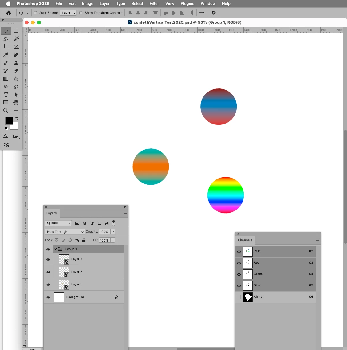

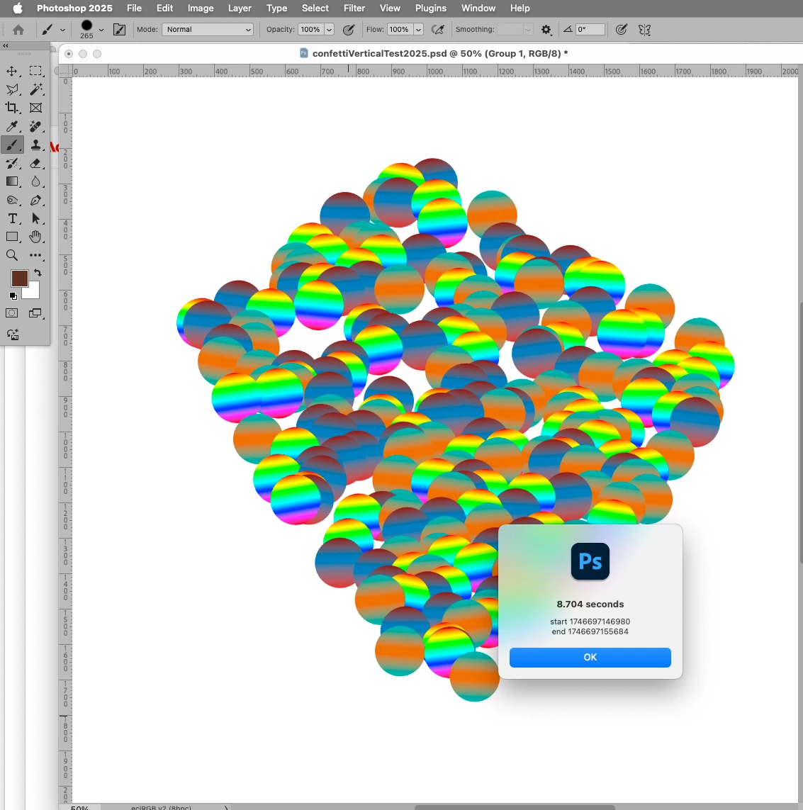

• Full color brush tips would be a useful improvement and I think Feature Requests on this issue exist. (Though they may have been back on the now defunct feedback.photoshop.com.)
• One can »high-jack« Tools one uses little (in my case the Count Tool or the Color Sampler Tool) to have a Script insert duplicate Smart Object instances to manually set positions by using Script Events Manager.
• A while back I created a Script (and while I think I posted it on the Forum I cannot locate the thread at current) for distribution of Smart Objects in a Group according to a Channel.
// copies, randomly moves and transforms artlayers in a laserset around based on an alpha-channel;
// size can be linked to the darkness of the alpha-channel;
// to even distribution out the target area can be split into segments to be treated searately;
// 2015, pfaffenbichler;

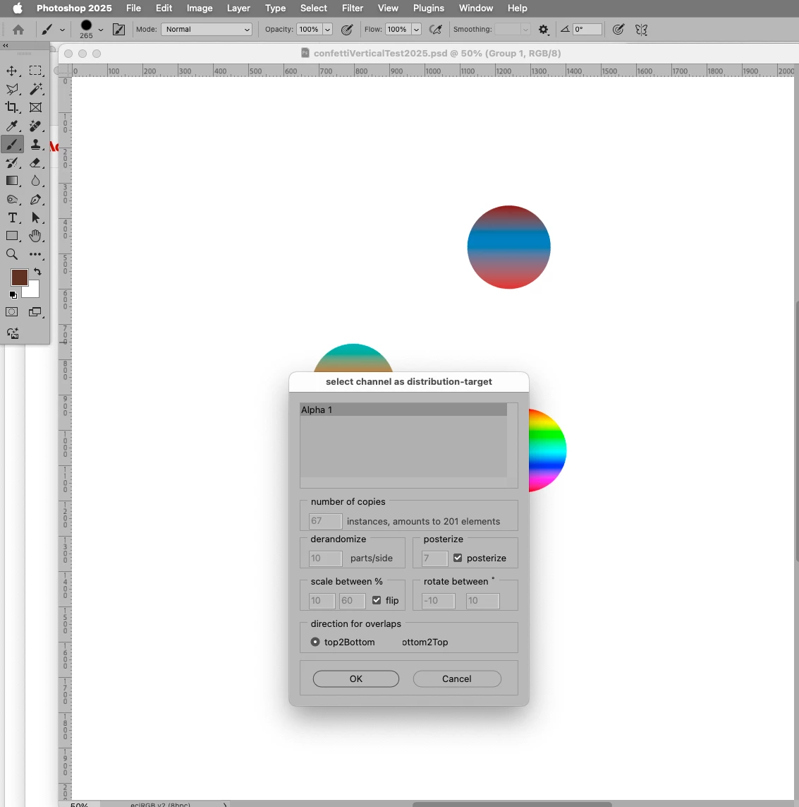

// set up dialog for channel selection;
var dlg = new Window('dialog', "select channel as distribution-target", [500,300,840,745]);
dlg.channelList = dlg.add('listbox', [15,15,325,137], 'field', {multiselect: false});
// populate the list with the open files’ names;
for (var m = 0; m < eligibleChannels.length; m++) {
	dlg.channelList.add ("item", eligibleChannels[m].name);
dlg.channelList.items[0].selected = true;
// field for copies;
dlg.copies = dlg.add('panel', [15,147,325,197], 'number of copies');
dlg.copies.number = dlg.copies.add('edittext', [12,12,60,32], thePref[0]/*Math.round(200 / theNumberOfLayers)*/, {multiline:false});
dlg.copies.numberText = dlg.copies.add('statictext', [65,14,320,32], "instances, amounts to "+String(Number (dlg.copies.number.text) * theNumberOfLayers)+" elements", {multiline:false});
dlg.copies.number.onChange = wholePosNumberKeystrokeFilter;
// update test to correct number;
dlg.copies.number.onChange = function () {dlg.copies.numberText.text = "instances, amounts to "+(theNumberOfLayers*Number(this.text))+" elements"};
// entry-field for fragmentation;
dlg.fragmentNumber = dlg.add('panel', [15,200,165,250], "derandomize");
dlg.fragmentNumber.number = dlg.fragmentNumber.add('edittext', [12,12,60,32], 0, {multiline:false});
dlg.fragmentNumber.number.text = thePref[1];
dlg.fragmentNumber.expl = dlg.fragmentNumber.add('statictext', [70,12,160,32], "parts\/side", {multiline:false});
dlg.fragmentNumber.number.onChange = wholePosNumberKeystrokeFilter;
/*dlg.fragmentNumber.number.onChange = function() {
	this.text = this.text.replace(",", "");
	this.text = this.text.replace(".", "");
	this.text = this.text.replace("-", "");
	if (this.text.match(/[^\-\.\d]/)) {
		this.text = this.text.replace(/[^\-\.\d]/g, '');
	if (Number(this.text) <= 0) {this.text = 1}
// field for rotate;
dlg.posterize = dlg.add('panel', [175,200,325,250], 'posterize');
dlg.posterize.number = dlg.posterize.add('edittext', [12,12,50,32], thePref[2], {multiline:false});
dlg.posterize.check = dlg.posterize.add('checkbox', [55,12,145,32], "posterize");
dlg.posterize.check.value = thePref[3];
dlg.posterize.number.onChange = wholePosNumberKeystrokeFilter;
// field for rescale;
dlg.scale = dlg.add('panel', [15,260,165,310], 'scale between %');
dlg.scale.number1 = dlg.scale.add('edittext', [12,12,50,32], thePref[4], {multiline:false});
dlg.scale.number2 = dlg.scale.add('edittext', [55,12,93,32], thePref[5], {multiline:false});
dlg.scale.flip = dlg.scale.add('checkbox', [100,12,150,32], "flip");
dlg.scale.flip.value = thePref[6];
dlg.scale.number1.onChange = wholePosNumberKeystrokeFilter;
dlg.scale.number2.onChange = wholePosNumberKeystrokeFilter;
dlg.rotate = dlg.add('panel', [175,260,325,310], 'rotate between ˚');
dlg.rotate.number1 = dlg.rotate.add('edittext', [12,12,60,32], thePref[7], {multiline:false});
dlg.rotate.number2 = dlg.rotate.add('edittext', [75,12,123,32], thePref[8], {multiline:false});
dlg.rotate.number1.onChange = degreesKeystrokeFilter;
dlg.rotate.number2.onChange = degreesKeystrokeFilter;
// buttons for direction;
dlg.direction = dlg.add('panel', [15,320,325,370], 'direction for overlaps');
dlg.direction.top2Bottom = dlg.direction.add('radiobutton', [13,13,145,30], 'top2Bottom');
dlg.direction.bottom2Top = dlg.direction.add('radiobutton', [115,13,290,30], 'bottom2Top');
dlg.direction.random = dlg.direction.add('radiobutton', [220,13,310,30], 'random');
dlg.direction.top2Bottom.value = eval(thePref[9]);
dlg.direction.bottom2Top.value = eval(thePref[10]);
dlg.direction.random.value = eval(thePref[11]);
// buttons for ok, and cancel;
dlg.buttons = dlg.add('panel', [15,380,325,430], '');
dlg.buttons.buildBtn = dlg.buttons.add('button', [13,13,145,33], 'OK', {name:'ok'});
dlg.buttons.cancelBtn = dlg.buttons.add('button', [155,13,290,33], 'Cancel', {name:'cancel'});
// show the dialog;
dlg.center();
var myReturn = dlg.show ();
if (myReturn != 1) {return}
else {
	app.togglePalettes();
	var originalResolution = myDocument.resolution;
	myDocument.resizeImage(undefined, undefined, 72, ResampleMethod.NONE);
var time1 = Number(timeString());
// get the number instead of the name;
	var theColl = dlg.channelList.items;
	for (var p = 0; p < dlg.channelList.items.length; p++) {
		if (dlg.channelList.items[p].selected == true) {
			theChannelSelection = p + theChannelNumber;
// collect the rest of the entries;
var theCopies = dlg.copies.number.text;
var theFragments = dlg.fragmentNumber.number .text;
var theScale1 = Math.min(dlg.scale.number1.text, dlg.scale.number2.text);
var theScale2 = Math.max(dlg.scale.number1.text, dlg.scale.number2.text);
//var theScaleProp = dlg.scale.proportion.value;
var theFlip = dlg.scale.flip.value;
var theRotate1 = Math.min(dlg.rotate.number1.text, dlg.rotate.number2.text);
var theRotate2 = Math.max(dlg.rotate.number1.text, dlg.rotate.number2.text);
if (dlg.direction.top2Bottom.value == true) {
	var theDirection = 2
if (dlg.direction.bottom2Top.value == true) {
	var theDirection = 1
if (dlg.direction.random.value == true) {
	var theDirection = 0

for (var d = 0; d < theNumberOfLayers; d++) {
	smartify (theLayers[d])
// collect layers again because after converting them to smart objects they are no longer identifiable;
var theLayers = collectLayerAndIDs(myLayer);
// check for the existence of a selcted channel;
if (theChannelSelection) {
// create an array of points within the non-black area of an alphachannel,;
myDocument.selection.load(myDocument.channels[theChannelSelection]);
var theChBounds = myDocument.selection.bounds;

var copyThis = 0;
// create rotation angles;
var theAngles = new Array;
	for (var p = 0; p < theTargetCenters.length; p++) {
// calculate angle between the maller and the bigger one;
		theAngles.push(theRotate1 + (Math.random() * (theRotate2 - theRotate1)))
	for (var n = 0; n < theTargetCenters.length; n++) {
$.writeln(n);
// create the copies;
		if (theLayers.length > 1) {
			copyThis++
			if (copyThis == theLayers.length) {copyThis = 0}
// determine the target position;
		var theHorOffset = Number(theTargetCenters[n][0]) - Number(theLayers[copyThis][2]);
		var theVerOffset = Number(theTargetCenters[n][1]) - Number(theLayers[copyThis][3]);
// calculate scale factors between the smaller and the bigger one;
		var theScale = theScale1 + ((theScale2 - theScale1) * (theTargetCenters[n][2] / 255) );

	app.preferences.rulerUnits = originalUnits;
	myDocument.resizeImage(undefined, undefined, originalResolution, ResampleMethod.NONE);
	writePref (theCopies+";"+theFragments+";"+Number(dlg.posterize.number.text)+";"+dlg.posterize.check.value+";"+theScale1+";"+theScale2+";"+theFlip+";"+theRotate1+";"+theRotate2+";"+dlg.direction.top2Bottom.value+";"+dlg.direction.bottom2Top.value+";"+dlg.direction.random.value, thePrefPath)
var time2 = Number(timeString());
alert(((time2-time1)/1000)+" seconds\nstart "+time1+"\nend "+time2);
