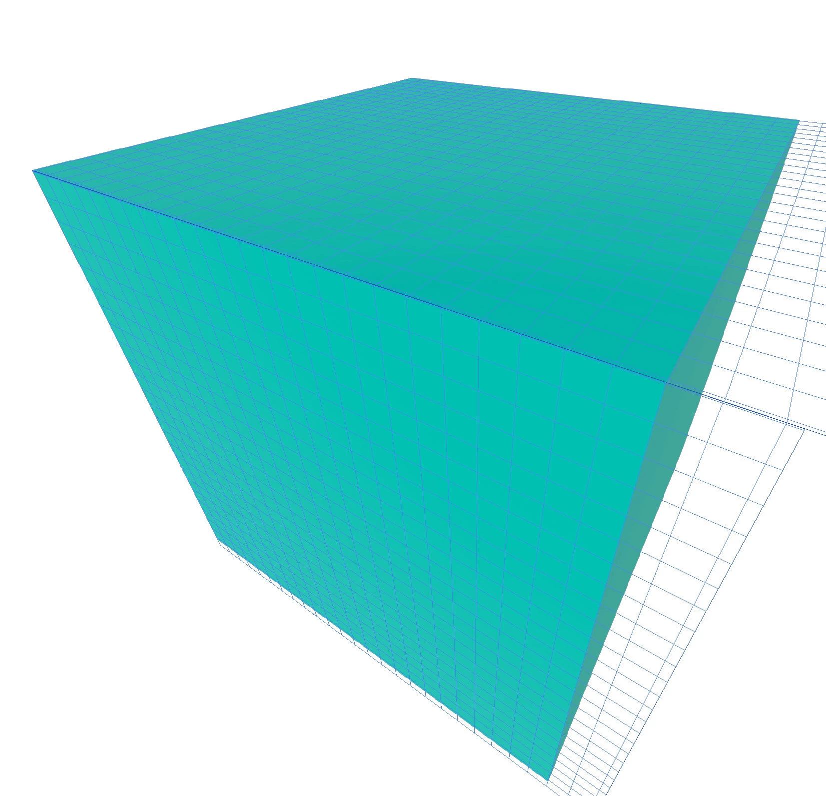

GRID SIZE
For example: I am working with a 3-D cube raster image that I have designated in my mind to be 24" x 24". I have set my two planes, and all I want to do is subdivide my plane grids into 24 x 24 grids so I can lay grout lines for a sheet of tile with the correct perspective spacing and size difference.
To achieve this is a lot more difficult than you'd think.
I have attempted to adjust grid size and play with extending the plane so my grid lines up to the edges of my cube, but I just can't get it to work. I'll get the X axis to be divided into 24 parts but then the Y axis is divided into, for example, 26 parts. Adjust the Y axis and then the X is off. Just feels like there is a lack of control there.
I'm not sure what the grid size units even are... are they by pixel? Are they a percentage? Maybe if I knew what they were, it would help. I can't seem to find that information anywhere...
It would still be nice to have more control over that as well so adjusting the grid size is less of a guessing game.
GRID RENDER
I was able to get one face of the cube to be divided into a 24x24 grid at grid size 121 (121 what? who knows...not me), but then I have to potentially use a different grid size in order for the other face of the cube to do the same? It would be nice to have control over which grids we can render to photoshop, instead of rendering all grids and then having to erase one you don't want. Perhaps a layers panel within vanishing point?
