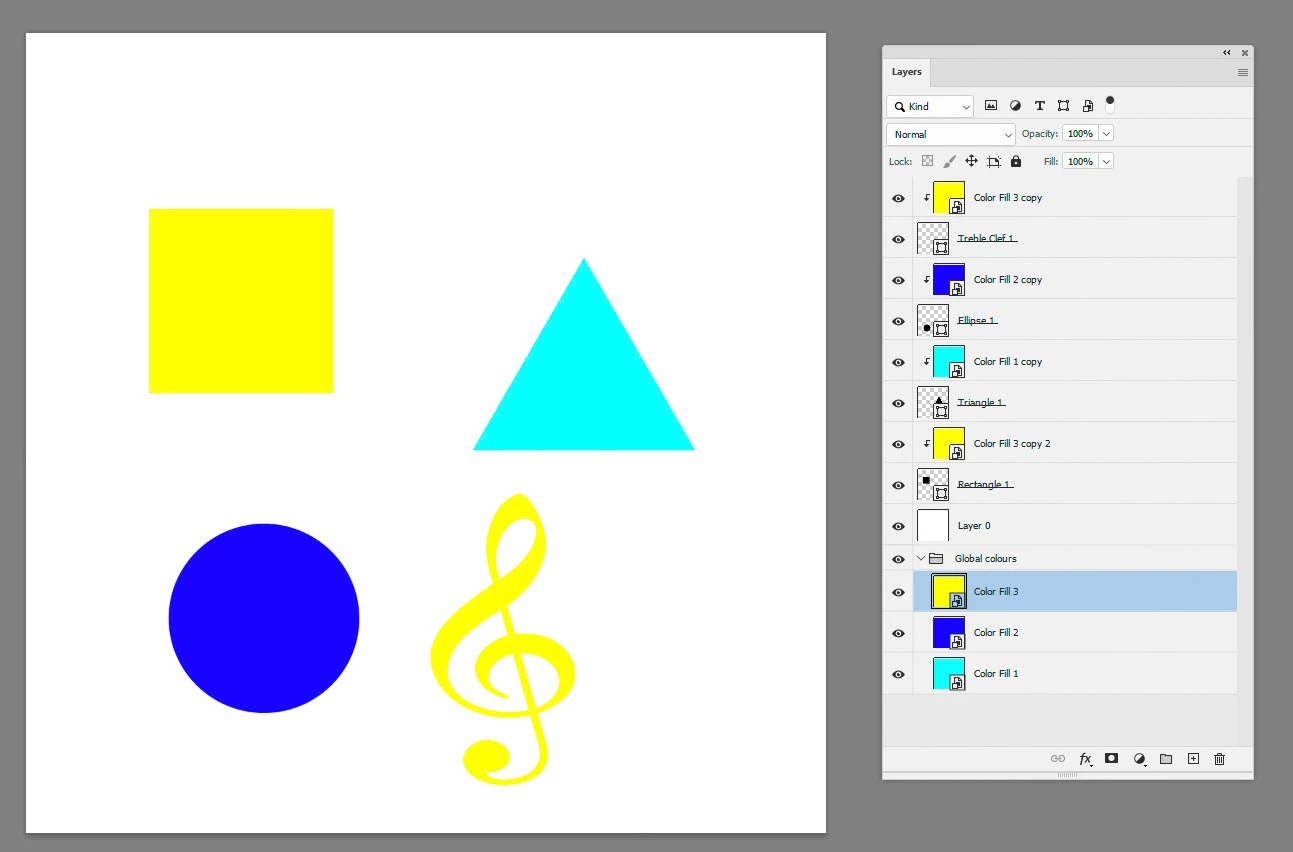

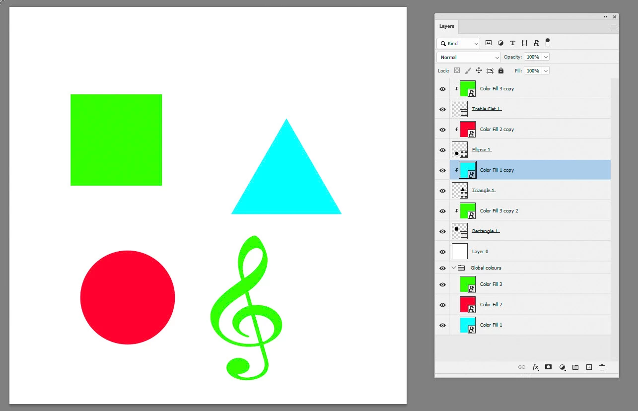

The issue with global swatches, as used in Illustrator and other vector based drawing apps is that, every object in a vector drawing programme is stored as a set of instructions on how to draw it, including the colour which is referred back to the swatch. So any changes to the global swatch result in any objects containing a reference to that swatch changing colour.
A raster program is very different. Layers are made of pixels, which can be coloured, but there is no reference back to any swatch. Indeed they do not have to have been made with a swatch, they could come from a colour adjustment or a photograph or a generated image. Each pixel is standalone, there is not reference on how to draw it. So with no reference back, changing a swatch does not change any pixels. That difference is not sloppy programming, it is a fundamental difference between a vector drawing application and a raster drawing application. That is why Photoshop has tools such as hue and saturation to recolour pixels. They are not changing a reference colour they are acting on every pixel falling within the range set by the adjustment.
That said there is something you can do if you have some shapes that you want to imitate global swatches and it relies on the fact that smart objects can be duplicated and each duplicate follows the original, in other words they are instances of teh original rather than stand alone smart objects.
So by putting your global colours into a smart object then clipping a duplicate to each shape, when you open and change that smart object, the colour of the clipped duplicates changes.
So in the set up below, the 'global' color fill layers are in the three smart objects at the bottom of the layer stack. Copies are clipped to each shape.
If I now open the smart objects at the bottom and change the colours, which I have done here for colour fill 2 and colour fill 3, the copies clipped to the shapes follow that change

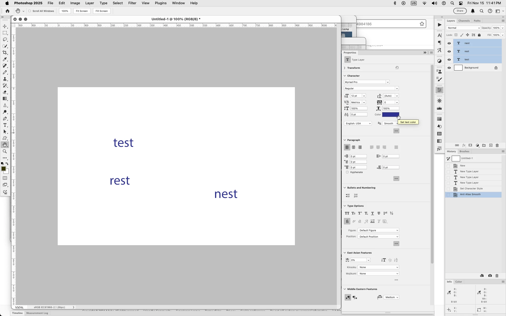

Jeff Arola
Nov 16, 2024 4:48 AM UTC
In Photoshop you can select multiple Shape or Text layers and change the color.
After you select the Text or Shape layers go to Window>Properties to change the color.
Text layer color in Window>Properties>Character
Shape layer color in Window>Properties>Appearance>Fill
Another way is to simiply select either the Text layers or Shape layers, go to Window>Swatches and pick a color by clicking on one of the swatches.

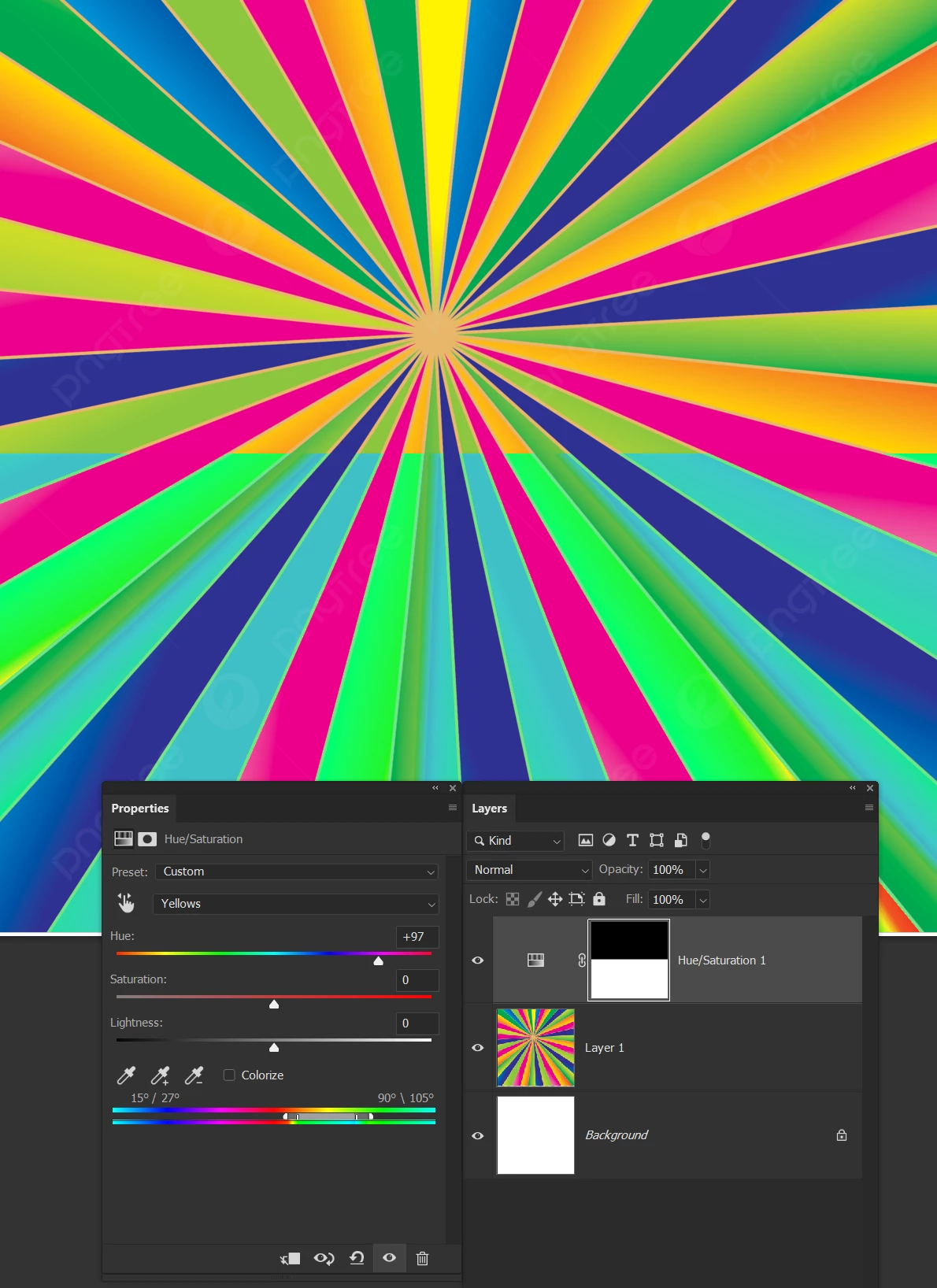

Trevor.Dennis
Nov 16, 2024 12:38 AM UTC
If I am understanding you correctly, there several ways you could do this.  A simple Hue/Saturation probably being the most simple.

By @dublove
Trevor pointed out that one can globally adjust the colour of pixels using an adjustment layer.
We can only work within the programming framework offered and Photoshop doesn't provide global swatches as found in illustration and page layout software.
