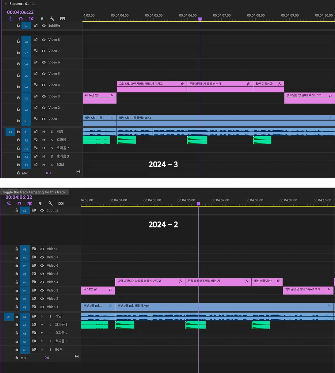

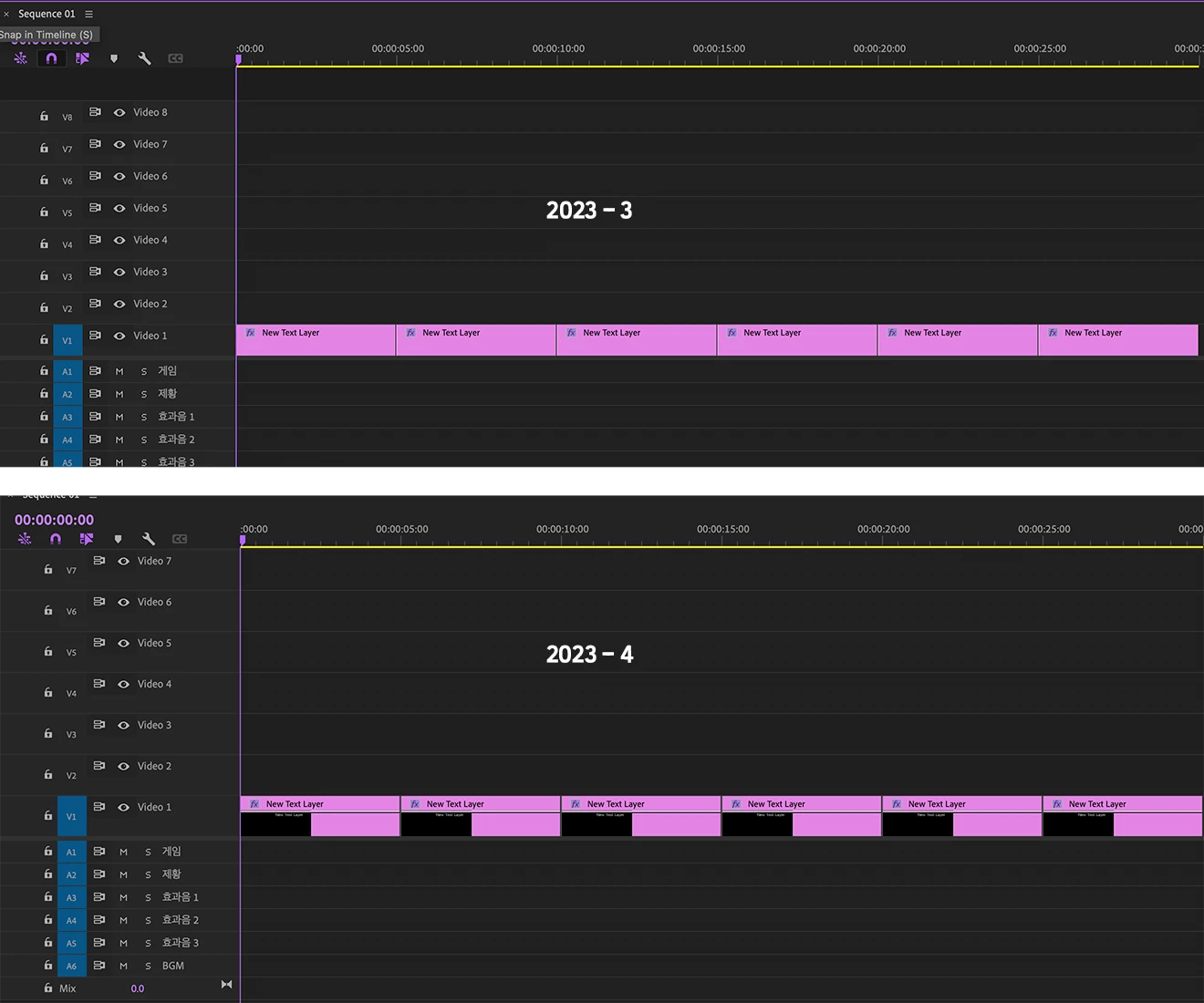

2. In earlier versions, the clip keyframe line did not appear when the timeline video track was zoomed in three steps, and the clip keyframe line appeared when zoomed in four steps.
From the update version, it is quite inconvenient for clip keyframe lines to appear from step 3 enlargement.
In my case, I would like to have a way to disable the clip keyframe line because I often move the layers, and I prefer to look at it with a bigger magnification.
It's so inconvenient to accidentally adjust the transparency when moving.
Or maybe it's something I didn't find, so if there's a way to disable it, I'd appreciate it if you could let me know.

I attached a picture, so I'd appreciate it if you could refer to it.
