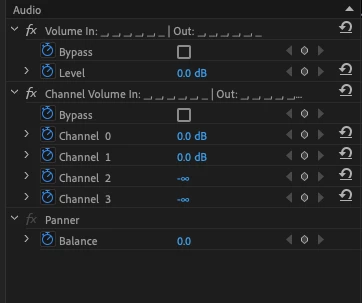

In addition, what should be 6 audio channels in the timeline, appear to be only 4 channels in the "effects controls" window. I can re-edit the original media back into the timeline, and it appears as 6 channels. At some indeterminate point they start appearing as 4 channels once again. In the "effects controls" panel, these odd clips appear to have additional settings beside the "volume in" and "volume out" headings - they appear to be nul values for 6 channels.

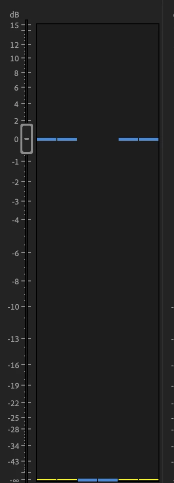

1st - both "bad" and "good" 6 channel clips appear the same in the clip mixer (here with channels 3 and 4 down to minus infinity)

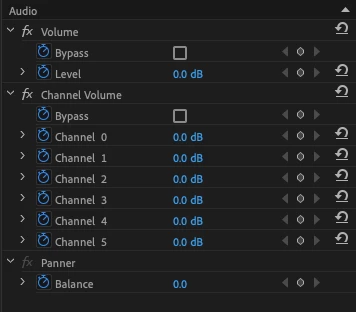

2nd - 4 channel clip showing normal with controls for all 6 timeline channels - no additional settings visible.
3rd - 4 channel clip showing only 4 channels in a 6 channel timeline - odd additional settings visible.
