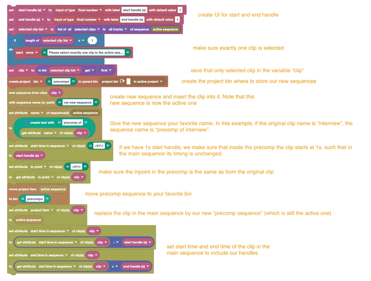

Hey,
I have a script idea for Automation Blocks and maybe someone can help get it going.
When working on clips that need further fx in another app like AFX or Fusion I like to create a seperate track for those clips and when I get them back to also place the new clips in a nested sequence so if there are several versions I can all place them ontop of each other so that all versions are available in case I need to go back to former version for some reason.
Right now this is a manual process of selecting the clip nesting it, naming it to the shot number and moving it to the bottom most track. It is not to much work at all but maybe could be automated.
Some nice features would also include the option to add handles so if the shots get longer there is a bit of a wiggle room(maybe not placing the nested clip right at the start of the Sequence but offsetting it in sequence it is comming from so that it still aligns properly; not sure if this is possible) without the need to move around clips inside the nest...
And if several clips are selected to coose if the user wants to place them all in one or separate sequnces(much like the pre-comp command in AFX)

To keep the location and duration of the clip in the main sequence unchanged should be even simpler:
Remove the two last blocks, which adjust the start and end time of that clip and instead set the inPoint of that clip to its current inpoint minus the start handle duration. That way make sure that the correct portion of the clip is shown (otherwise it will be offset by the start handle duration).
Not sure about the other issues. Can you identify when they are happening?
Note that we are inserting the original, unmodified clip in the nested sequence. Hence, if you have any effects, time stretching or other modifications applied, they won't carry over to the clip in the nested sequence.

Here is a version which adds handles:
I added it to the Community Library at
Clips/Nesting/Precompose With Handles.xml

Hey Mathias,
thanks for helping(as always when I have ideas/problems with AB). I am now able to create new Sequneces from the selected clips and also rename it to the same name as the clip.
But how can I replace the selected clip with the newly created sequence?
Is there also  a way to also add in handles so that the newly Nest so that the it is longer especially at the start if the fx shot is made longer for some reason?
My current version

Replacing a clip by a new sequence containing the clip can be achieved as follows:
1) creat a new sequence from clip
2) set the attribute project item of the original clip to the new sequence
