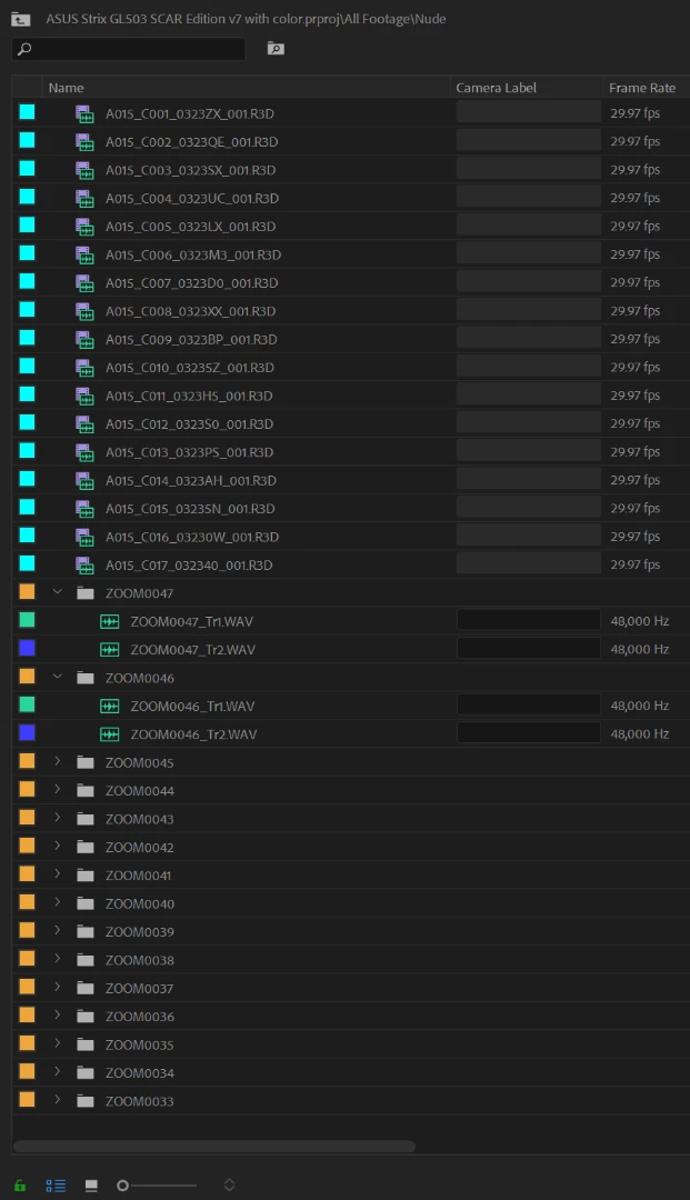

    I've got a big folder here full of 54 audio and video files. All of them have timecode. It should be one button press to synchronize them all, per layer, in the timeline.
    This guy found a brilliant workaround where he uses the metadata panel to assign Camera Labels to multiple clips simultaneously. I haven't seen anyone else talking about that. How to sync with timecode in premiere pro - YouTube
    From there, he uses the normal multi-camera sequence method.
    Problem: .r3d clips apparently do not allow you to attach a camera label?? The option is greyed out, as you can see in the screenshot above.
    I also can't seem to use the metadata panel to assign camera labels to .wav files either. The option does not even appear. Probably cause they're not "cameras."

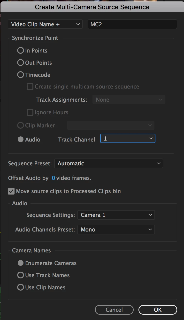

    Maybe I'm doing something different than everyone is talking about, but the Multicam feature worked perfectly for me.
    I had external ISO audio recorded on multi-channel WAV files. During production, the audio guy sent me a wireless mixed feed which was recorded on one of the video's audio channels (He also sent me timecode which was recorded as audio on the other audio channel on the video, but it turned out this audio timecode was not necessary).
    All the clips were processed as a batch.  I did not have to match the wav files to their respective video files. I was able to select ALL wav and video clips and do a Multicamera Source Sequence using the AUDIO to sync everything.  I had 40 clips with 8 channels of audio, and it took less than 10 minutes to create the new material.  It also identified the audio or video clips that did not have a sync partner.

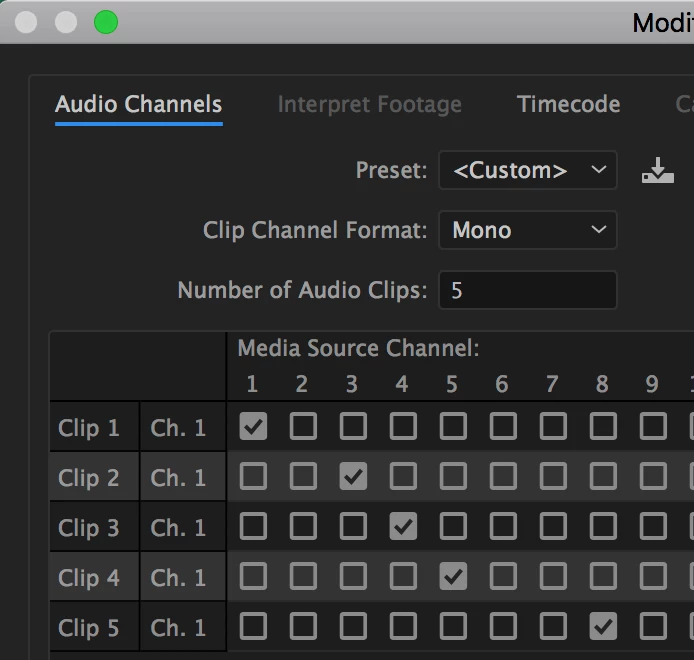

    If you have uncessary channels on your wav files, you can then map them out from the multicam source files using the Modify Audio Channels feature.  Here, I eliminated channels 2, 6 and 7.
    Theres a decent tutorial about this here:
    https://vimeo.com/123657864
    Nov 5, 2017 6:20 PM UTC
    Adding screen shots that didn't make it in on last post:
