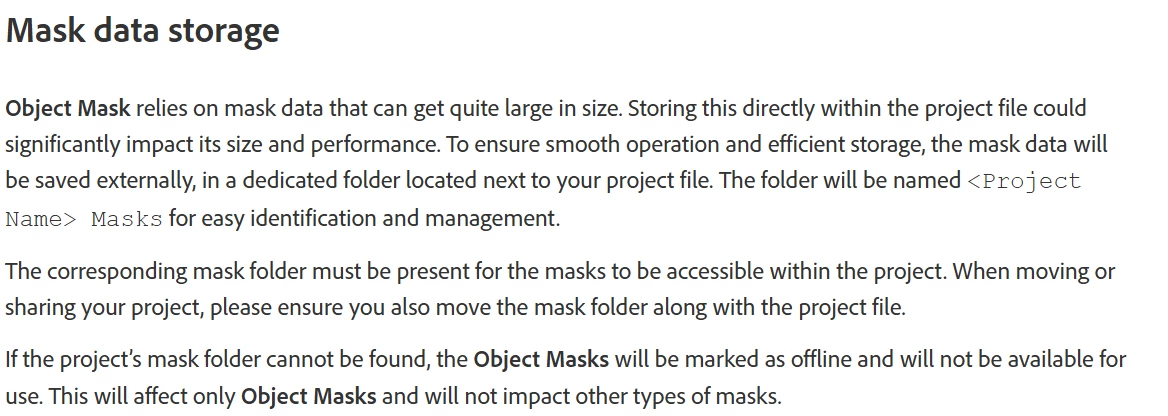

So small bit of feedback,  beeing focused on the Beta these days, and they have a new feature in the public beta for masks... and guess what - they are storing the mask data externaly!  This is great news, and I hope they do the same thing with warp data also;
All I can say is Bravo - moves like this start to restore my faith in the devolopment - not only is this new mask tool really promising - but the very logical decision to have a folder for object masks and good documention around this a good step forward that I hoep they apply to warp stabilize now also.
